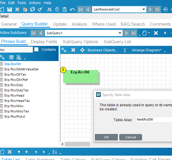

For “last transactions” type queries, I have a method I use which does not require subqueries. Others have subquery methods and those work just as well. I start with two copies of the table dragged onto the design field, in this case RcvDtl. For the “phantom” next transaction, I will change the name of the table to NextRcvDtl.

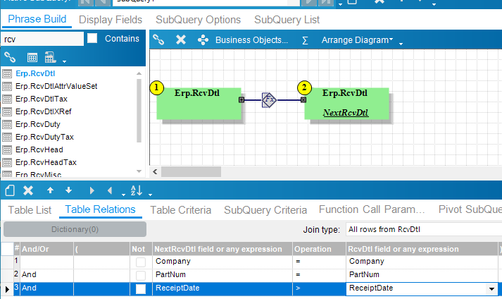

When you join the tables together, Company and PartNum have to match, and some field that indicates sequence, needs to be greater in the “next” table than in the “current” table. I don’t like to use dates because if you receive the same part twice in one day, it could cause an error in the query. If that’s not an issue, the method shown here should work. Change the join to Left Join also called “all rows from RcvDtl.”

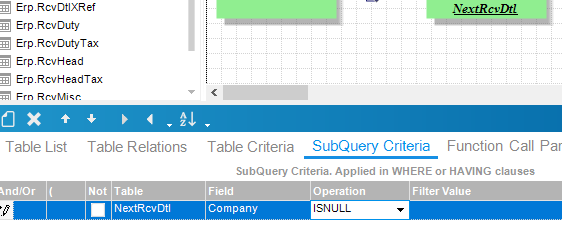

Add a subquery criterion to require NextRcvDtl.Company to be ISNULL.

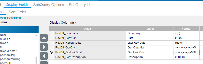

Add your display fields, all from RcvDtl.

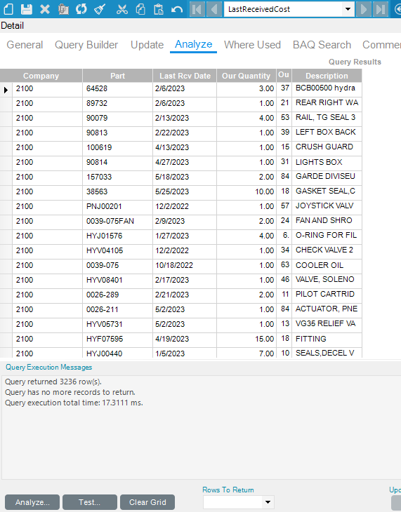

Hit the Test button and spot check the results against Part Advisor or Receipt Tracker. This should provide a more believable set of information than just looking in PartCost, because you want to know when it was received, and what the cost was for that specific transaction.

The left-join tells Epicor to find the current receipt and if there’s a next one, find that receipt as well. Then your subquery criterion tells Epicor to show only receipts for which there is no next one found.
This seems to work very well. Thank you so much! I did have to switch the operator around on the Receipt date though. Have a great day!
