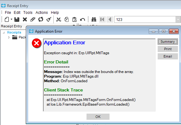

Thanks Chris. That’s where I am now running into issue is passing the correct parameter to the MtlTags. I am getting “Index was outside the bounds of the array”.

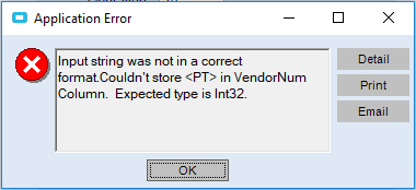

Right now as a test, I just put in the txtPackingSlip textbox. However, I am getting an error when trying to launch the MtlTag form.
If I click “OK”, then it opens up to MtlTag forms. The one on the left looks right, but then it also open the one on the right which I don’t know where the qty 2000 comes from.
This is expected because the form expects 11 params as I showed. Anything else will break it. Sounds like you need to use ContextValue and custom handling, similar to what I described above.

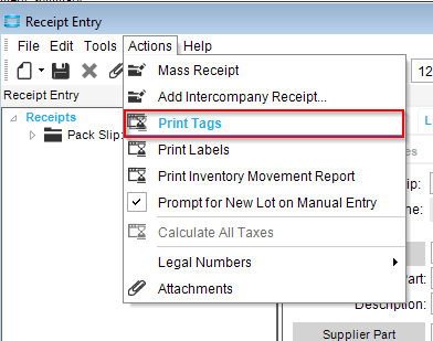

that is opened because the menu item is passing those params in ValueIn, so you will need to hijack that button to stop that. ValueIn = null;

Yes, you still need the LFO, but…
  • You cannot use ValueIn as its used by base processing on the MtlTags form
  • You must override the menu item the opens the MtlForm (because it sets that data in ValueIn which will be parsed by MtlTags
  • You will have to pass you params in ContextValue
  • In MtlTags, you will need to parse the ContextValue you passed and perform whatever actions you desire

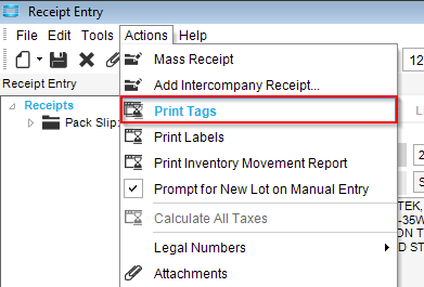

Are you using the existing menu item to call the form, or did you create a new one?
If you are using the existing, you need to ensure the base code isnt called. I would assume you used a BeforeTookClick event, if so, set the args.Handled = true to stop the base code.
