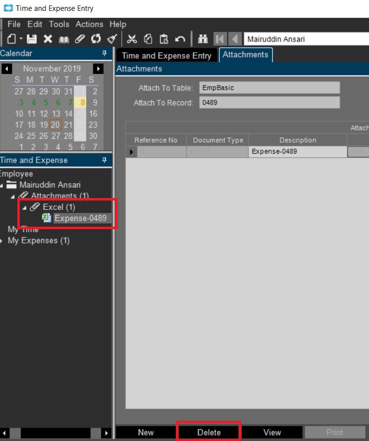

Dear Experts, How to disable delete action & button in Attachment panel or provide limited access to users delete attachment.

The attachment panel seems to be protected from accessing inside the customization code. If we try creating a BPM on (for example: Purchase Order > Method Directive > Pre Processing). I’m able to throw an exception if we click delete on attachment panel by checking the row state. Point is the file references in the XFileAttch remains intact however the physical file has been moved into the delete folder.

All, Appreciate your response. However, I have managed to do this as two steps.
Step 1: I have written a code in the attachment tool click to lookup all the buttons available on that particular form, identify the delete button and disabled it. However, the problem does not stop there. Users can click on the attachment and use the “X” on top to delete that.
Step 2: If you trace the delete event on attachment panel and the delete event on “X”, the delete event on “X” will call the GetAttachmentPath method but the former doesn’t. which give me the flexibility to write a BPM to see the path and throw the exception.
