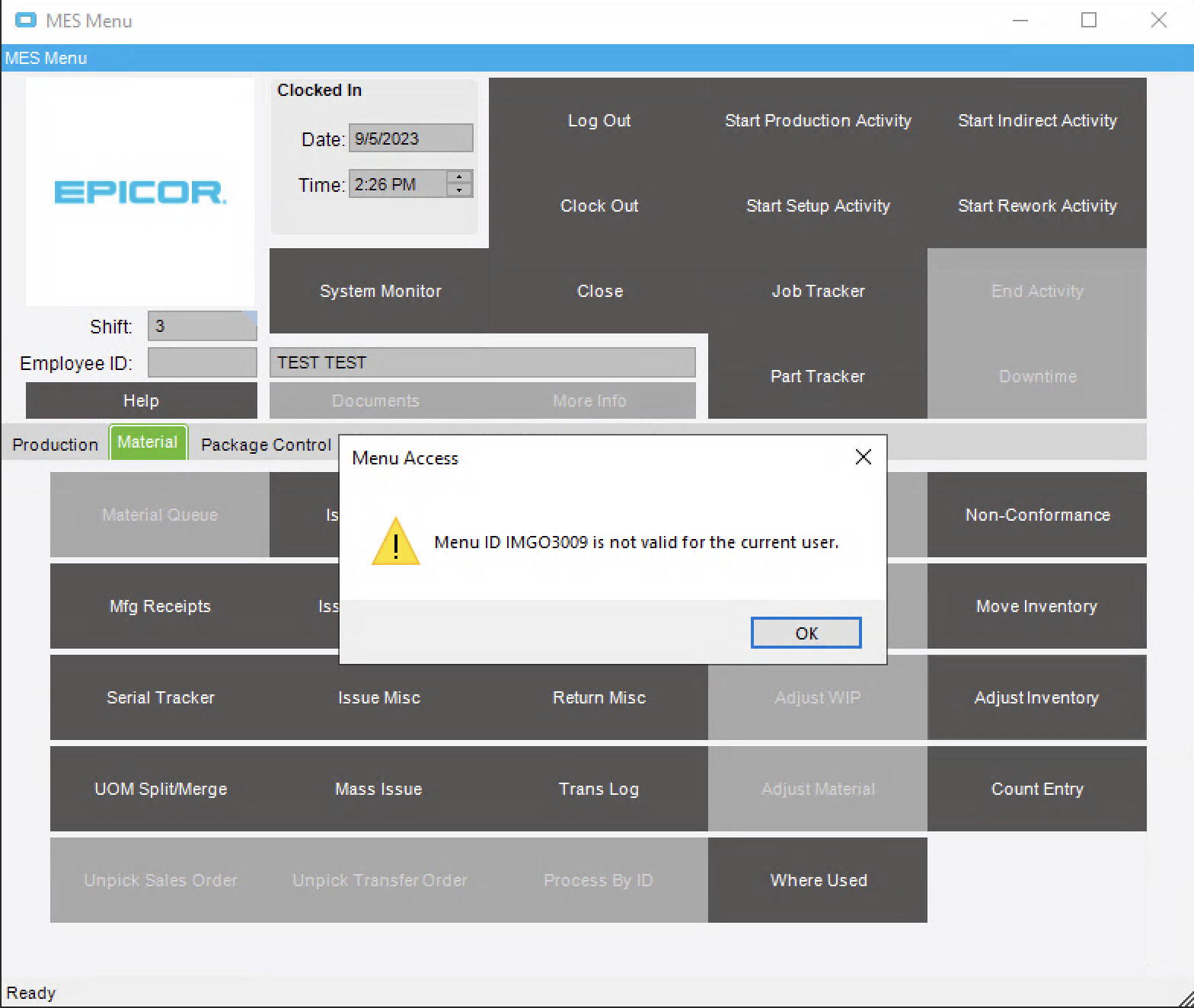

That’s still launching a menu ID somewhere in the menu tree. The button might show up but they should get an error launching the screen. MES is still impacted by Menu Security.

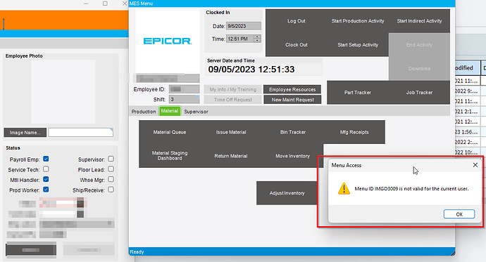

This is the Menu ID
Logged in as a shop floor user with Mtl Handler enabled

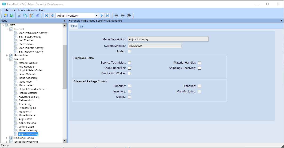

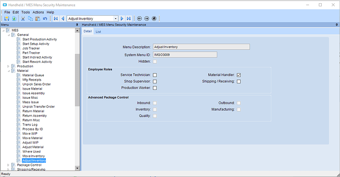

You can set this in ‘Handheld / MES Menu Security Maintenance’
This is good for visual reference, it will disable the button, but I would still set proper group security at the menu level, or even betterer that and process security if you’re feeling spunky.

So @jgiese.wci was correct all along. What we did wrong was that when testing to see if the rights applied to different MES employee IDs, we were doing it when signed into Windows as a user that DID have the Epicor rights. Because we are SSO, that little detail is easy to forget about.
Anyway, when we did test removing the rights via Menu Maint and then signing onto Windows as SHOP, then MES started behaving as you describe. Sorry to waste your time, that was a foolish mistake on my part! :man_facepalming:
