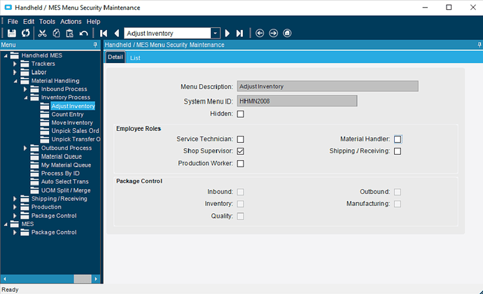

When that didn’t work, I used the Handheld / MES Menu Security Maintenance and removed access from the Material Handler employee role and only gave access to the Shop Supervisor role.
The handhelds are still able to open that menu. I feel like I’m missing something basic, but I’m at a loss.

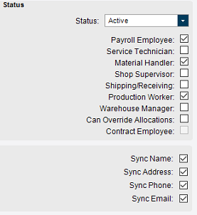

Thank you so much for the reply. My contact on-site has been testing with an employee, below is the role section showing what’s selected. Notably, the Shop Supervisor is not selected.
