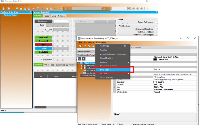

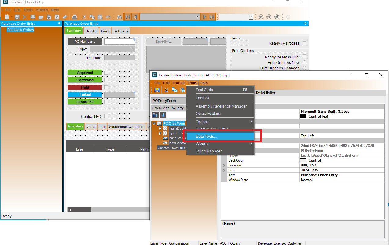

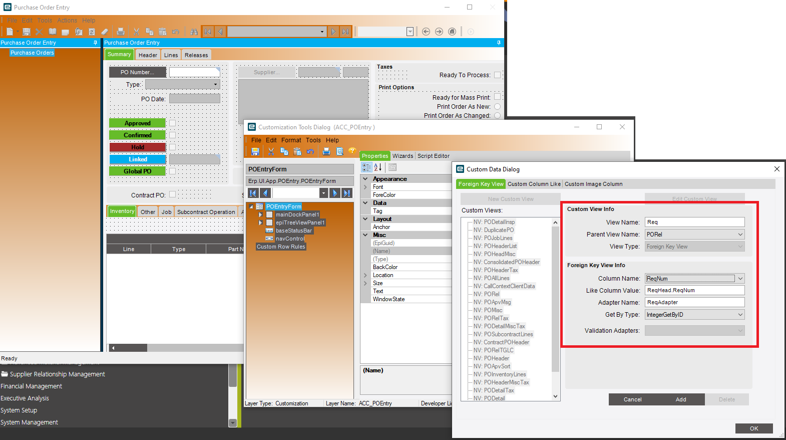

You could add a Foreign Key View to your PO screen. Use the PO Rel table as the parent as shown in the following image. Once the Foreign key view is added, you can then add the Req number to your PO Entry screen.
To add a Foreign Key View, click Tools > Data Tools in the Customization Tools Dialog
