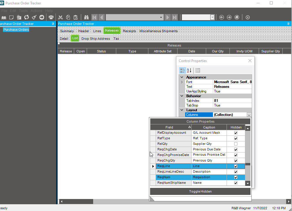

I thought the Req info would be hidden in the Line’s List tab but it’s on the Release. We’re still Classic UI if you’re Kinetic it should be similar to Personalize and set the columns to be unhid. If you have Customization access you can set it to Base as well.
@rski It will be in the comment field in the po entry screen.
