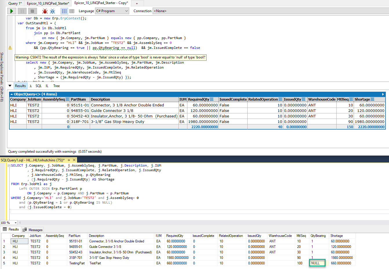

I have an SQL query that I’d like to convert to a LINQ expression but have an issue with a nullable bool.
SQL
SELECT j.Company, j.JobNum, j.AssemblySeq, j.PartNum, j.Description, j.IUM
		, j.RequiredQty, j.IssuedComplete, j.RelatedOperation, j.IssuedQty
		, j.WarehouseCode, j.MtlSeq, p.QtyBearing
		, (j.RequiredQty - j.IssuedQty) AS Shortage
FROM Erp.JobMtl as j
	Left OUTER JOIN Erp.PartPlant p
		ON j.Company = p.Company AND j.PartNum = p.PartNum
WHERE j.Company='HLI' and j.JobNum='TEST2' and j.AssemblySeq= 0
	and (p.QtyBearing = 1 or p.QtyBearing IS NULL)
	and (j.IssuedComplete = 0)
LINQ
var OutStandMtl = (
from jm in Db.JobMtl
	join pp in Db.PartPlant
		on new { jm.Company, jm.PartNum } equals new { pp.Company, pp.PartNum }
where jm.Company == "HLI" && jm.JobNum == "TEST2" && jm.AssemblySeq == 0
	&& (pp.QtyBearing == true || pp.QtyBearing == null)
	&& jm.IssuedComplete == false
select new { jm.Company, jm.JobNum, jm.AssemblySeq, jm.PartNum, jm.Description
	, jm.IUM, jm.RequiredQty, jm.IssuedComplete, jm.RelatedOperation
	, jm.IssuedQty, jm.WarehouseCode, jm.MtlSeq
	, Shortage = (jm.RequiredQty - jm.IssuedQty) });
Error
CS0472: The result of the expression is always ‘false’ since the value of type ‘bool’ is never equal to ‘null’ of type ‘bool’
It’s doesn’t like:
This query gives me a list of all outstanding mtl on a job, except parts on the fly because they don’t have PartPlant records… In SQL I can use pp.QtyBearing IS NULL, which gives me the correct results. However, in C# LINQ it seems to knows that pp.QtyBearing is a non-nullable bool, which is why I get that message.
Any other way to tackle this?

Thanks @asmar, that worked! Wish I understood LINQ a little more.

@timshuwy, I tried casting the (bool?) but it didn’t solve my issue. It was the Left Join and DefaultIfEmpty() that ended up working.
