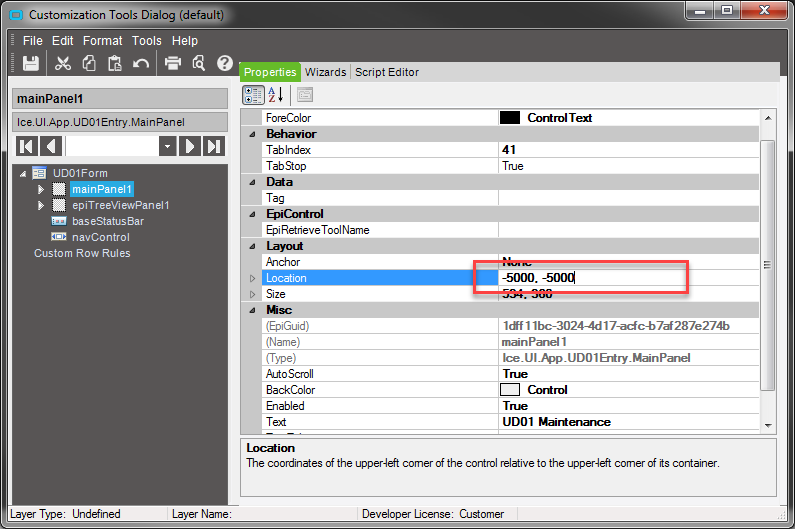

Some people just move them off page (large negative X value).
may not be able to hide, but make the size 0,0 and position -1,-1 ?

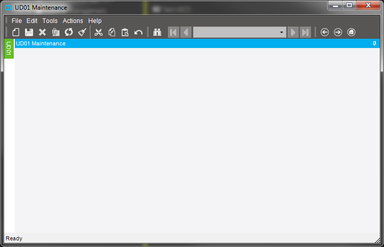

Ok so this is a bit weird. I created a brand new layer and attempted to change the location of the mainPanel1 in a UD01 form.
This also makes the form reflect the change:
If I click anywhere else, it resets to the base 0,20 location:
And the form shows the controls again:
What else is weird is after loading the customization again, the XML Editor shows the values that I had entered:
you may need to leave the main panel alone and shrink/move the detail and list tabs
Ok got it to work. The secret is disable epiTreeViewPanel1, enable mainPanel1, make groupBox1 in detailPanel1 invisible, make btnKey1Field invisible, make listPanel1 invisible. Also, when loading the customiation in developer mode, unpin the epiTreeViewPanel1 control and click save layouts.
