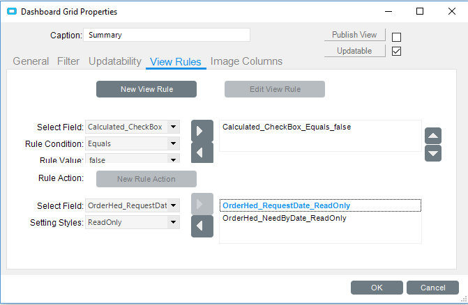

Try doing a basic row rule in a customization on the deployed dashboard instead. You should not have to write any code that way (the wizard will do it for you).
this is what you are looking? if yes go dashboard gird properties -> View Rule Tab -> create new rules
Yes! This is what I really want to do, but I can’t figure out how to use the rule to change the locked status.
It seems like I can only set visual styles with the rules. How do I use the rule to set the locked status for other columns?
here is
This is good. I was trying to set the rules in my customization. I forgot to go all the way back to my dashboard definition. :stuck_out_tongue:
Right now the rule turns the read-only value on when I click the checkbox. How do I invert that so the read-only is set to false when I click the checkbox?
it will take care automatically

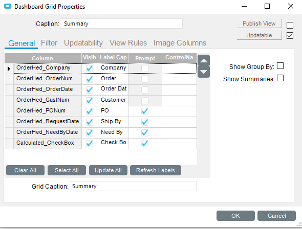

Did you set the Quantity and Date fields to “Prompt”?
Yes you have to set Prompt editable fields
Ahh! I forgot to set the rule to checkbox = false.
