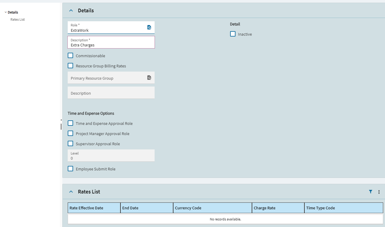

I’m playing with it, this only works for “Project Jobs”, however it appears I can select a Role Code (with a Rate) and a Production job… playing with that now.
So it appears that Roles can carry a rate both in the Employee Record as well as the Role Itself. And within Time and Expense Entry I can select a Role when entering Labor Detail.
However it appears that it isn’t affecting the reported labor on the job… (still investigating… anyone have ideas about this setup)?

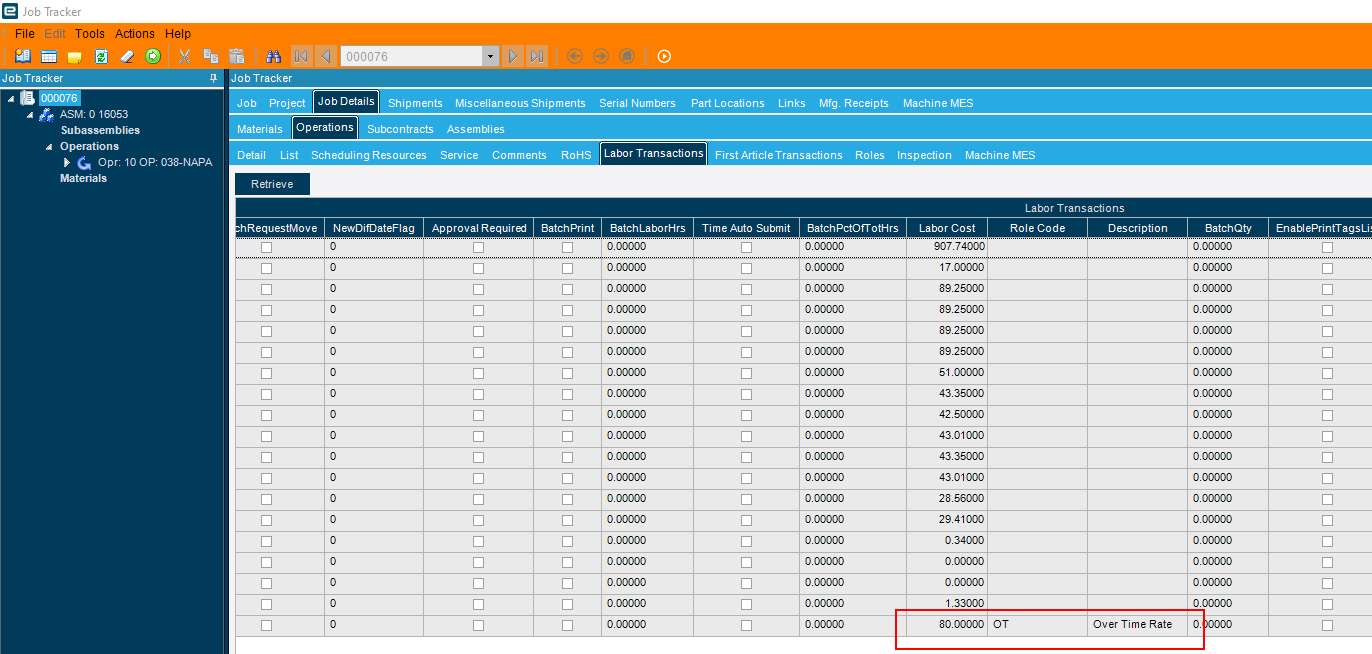

Interesting so that setup works only for Project Jobs as @Mark_Wonsil mentioned, however I played with a very simple BPM that changes the Role Code and Labor Rate based on the role code and it appears that Epicor allows that override to persist and flow through properly if I just fill in the field via BPM.
So this is definitely an option when they go to report labor we could lookup “IF” they meet overtime-criteria and then swap the ROLE code on the fly via BPM.
