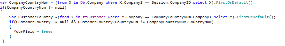

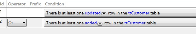

I believe Company field is renamed as Company1. Not sure why. But I was able to get this working with a condition widget first
and then custom code widget with this code:
I don’t have any boolean field to test but my messages fired correctly. Give it a try.
It’s not working for me, as it is not passing the first IF statement. When I add
var vCompCountry = CompanyCountryNum.CountryNum;
right before the first IF and display the result in a message, I get 0.
It is hard to tell. Are you using variable vCompCountry created in the BPM or in the custom code?. Am I over-seeing anything? I believe we cannot user variable directly.
