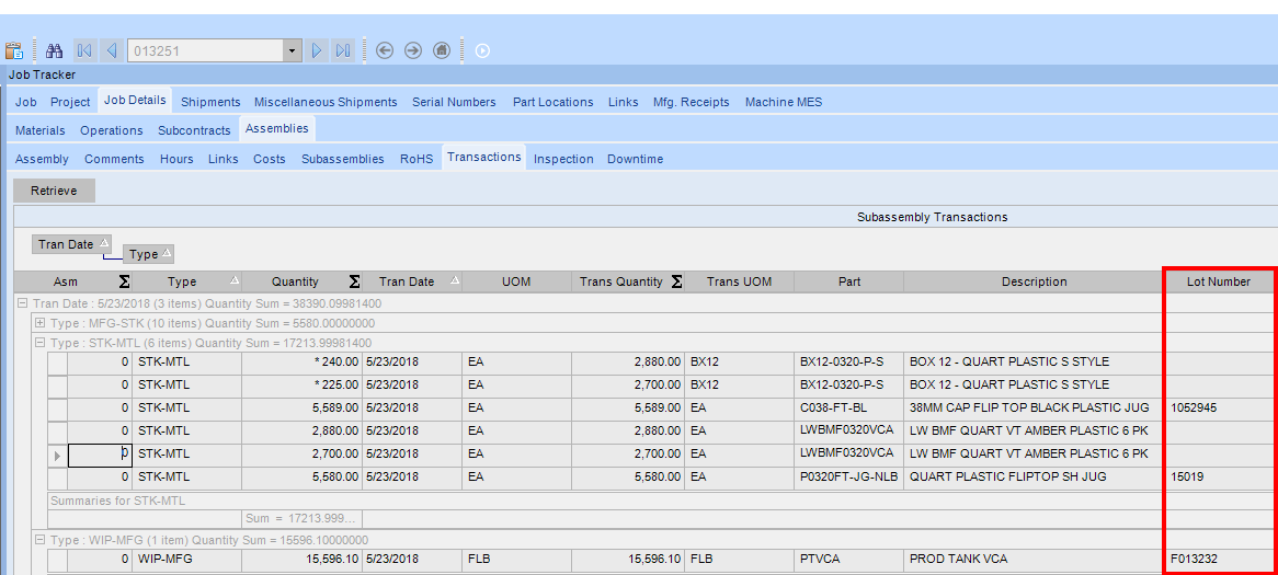

I will second what Mike said. We had the same issue as you with QA feeling too many steps were involved and it was impacting mock recall times which are required for some of our certifications. If it is just a single or a couple jobs you need to look at the Job Tracker JobDetails -> Assemblies-> Transactions tab will get you an all in one view with lot numbers. I group mine by date and tran type for ease.

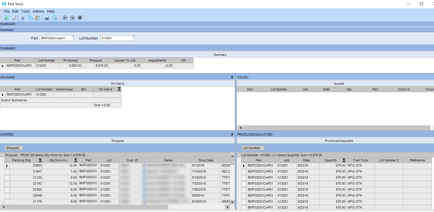

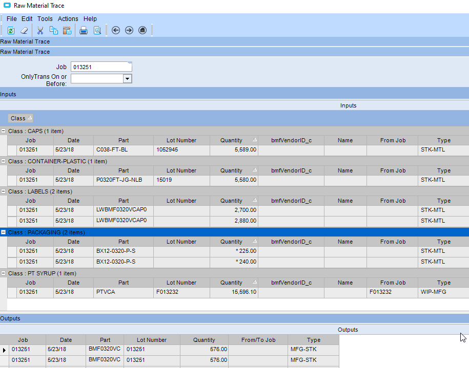

At their request I also built a couple dashboards. One called part trace that tracks the transactions and OH status for the part made (or material if the issue is with a specific lot of material). And one that shows the Transactions for the job. Not perfect, but between these two they can usually pretty quickly get the info they need.
@Norelco2 this is sweet!
I see in your raw material trace you supplied job 013251. In that trace I see that you have a part called PTVCA that came from Job F013232. Our quality is asking that the trace also include all of the materials and lots that went into job F013232 in the same dashboard. Do your quality people ever need that? Is it already there and I am not seeing it?
It is not but could be, our issue is we have a lot of like parts that carryforward from job to job without a clear cutoff at times. When I blasted out the dashboard to the next level it ended up returning dozens of jobs and all their transactions so wasn’t a manageable amount of data to view at once. They normally just export the results to excel, put the new lot number (which equals the job number on our site), refresh, rinse and repeat.
