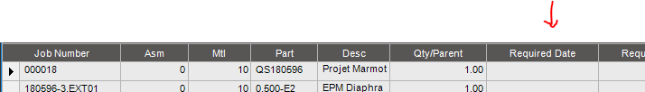

Hi, I have a dashboard called ‘Project Dashboard’.
I want that in one of my window (Project Material), I can modify the required date for the material like that:
How can I do that? I don’t know why the fields in the first image are updateable, they are not read only but I figured that by doing the same thing it might work but it’s not,

I started by making my BAQ updatable. After this, still in the BAQ page, I went into the ‘Update’ tab. I chose the method that I wanted to update the field (BPM on X table). In ‘General Properties’ under ‘Update’ table, I checked the field that I wanted to update: JobMtl_ReqDate.
With that in mind, I went back to my Dashboard. In my query property, I checked ‘updatable’ and I also checked the field that i want to update in my table
