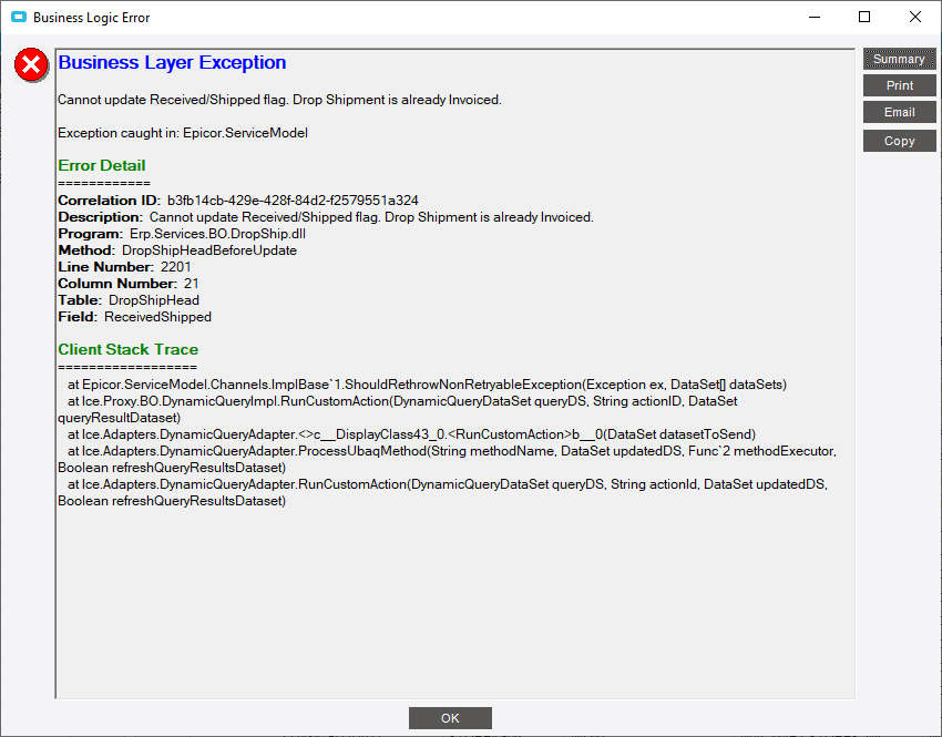

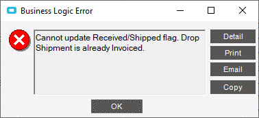

The problem here is that when the Drop Shipment Invoice is deleted it marks the Drop Shipment as not invoiced anymore (proper Epicor functionality no worries there) but then when I go to manually update the value to show that it is indeed invoiced, I get an error:
It seems if I try to update the value and run the DropShip.Update BO, it throws an error if the ReceivedShipped flag is set to true (which in this case it should always be true).
