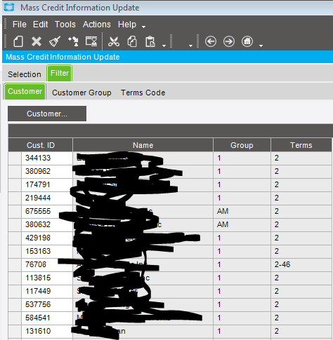

I want to run Mass Credit Information Update every evening on a specific filtered list of Customers at 1 am. I think I have figured out how to do everything except for how to create the filtered list it runs on. I have a query that right now I am running the BAQ, copying the results and manually pasting them into the Customer Filter section and setting the Schedule to run overnight and then submitting that. I would like to get this to where I don’t have to manually remember to do anything on a daily basis and that it will automatically run. Any help?
Did you do a trace of where in the parameters of this process the filtered list goes?
And I assume this list is dynamic?

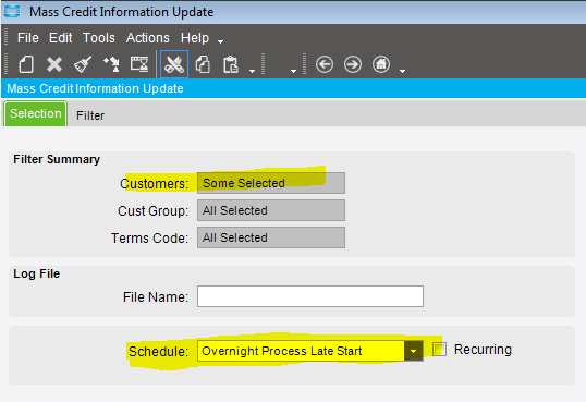

I may be oversimplifying this, but can’t you just check the box for “Recurring” on the schedule?
I thought when you scheduled a process like this, it usually retained all the Option and Filter settings.
Clarification Edit: when Recurring is enabled.
Yes, that is what I was thinking … but I failed to mention the recurring checkbox
I haven’t done a trace yet, I will try that. And yes this list is dynamic and will constantly be changing.
That is fine but I need it to run the query itself. Right now I am manually copying and pasting in the customer’s I want to run the credit on. I don’t want to have to do that. I want it to run off the query.
I do plan to make it recurring when I can figure out how to make it update the list itself based upon the query results.
