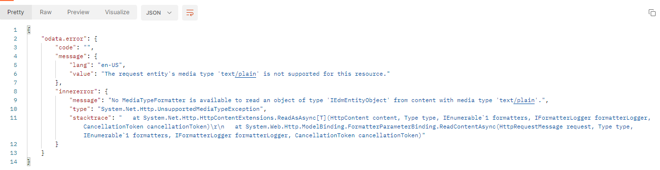

When looking in DMT for an entry there were none shown. When trying to build an updatable BAQ I noticed there is no business object to select. I went ahead and tried adding the vendor table to it and was able to perform an update on the fields within the VendAttr Table without error. But, when calling the list of items again the data did not stick. The last venture I tried was finding a means of getting the data in using Postman. However, when I try posting/patching through an updatable BAQ I get the following error:

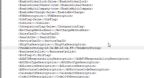

It’s the vendor attribute string in the vendor temp table. You’ll have to get that field in the temp table, set it, (probably along with a row mod to U) and call update.
This is one that you will probably have to custom code. The Vendor temp table takes in a ~ delimited field, then does the work to split it and put it into the vendor table. So they won’t have an easy to pick BO to do it for you from a UBAQ.

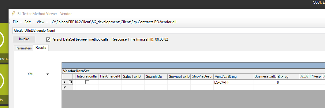

So you would build this using the Advanced BPM update in the UBAQ, the write your own base update method. You can try doing a single row with the widgets. GetByID, set the vendorAtt list field (you’ll have to format it correctly) and set the Row mod to U, then call Update.

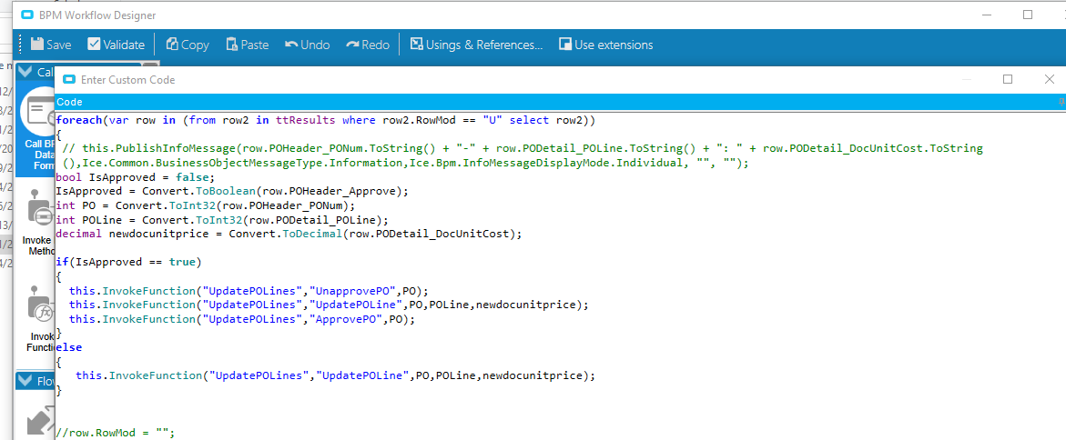

Dylan, we get price increases from vendors and we need to update all our open POs accordingly… we write POs way out into the future.
I built a dashboard that calls an updateable BAQ. For each row in the results that is updated, I call a function to update the line price.
You will see the initial foreach statement that loops through the results where RowMod is “U.”

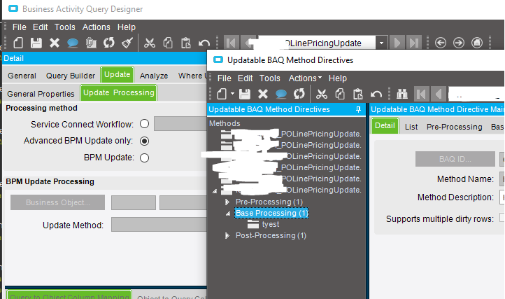

Dylan I am not sure this is the right thing to do, but I had to put mine on the update method at the base processing method to get this to run. Now I am not updating anything using the BAQ or the BAQ business objects, I am calling custom functions so I think it is fine, but I would rather have someone more experienced chime in @hasokeric @Banderson @jgomez

Dylan, I would pause and wait for a response as to what you are doing in the advanced BPM update. Ask Brandon where he is putting his code and what that warning message is and how to get around it.
I don’t know if what I did is right, but I think it’s fine for me because I am not using any base functionality baked into the updatable BAQ, I am wanting to call my own code.
Give me a bit to break it all down. @dgreenEA , that message you are getting comes when you don’t have the BPM in the BAQ set up to do the update. That either means you didn’t put it in the right spot, or you didn’t click the enable checkbox.
@utaylor, the BPM that you are posting is not a UBAQ bpm. That’s a BPM on the actual BO, which is not what we are going for here.

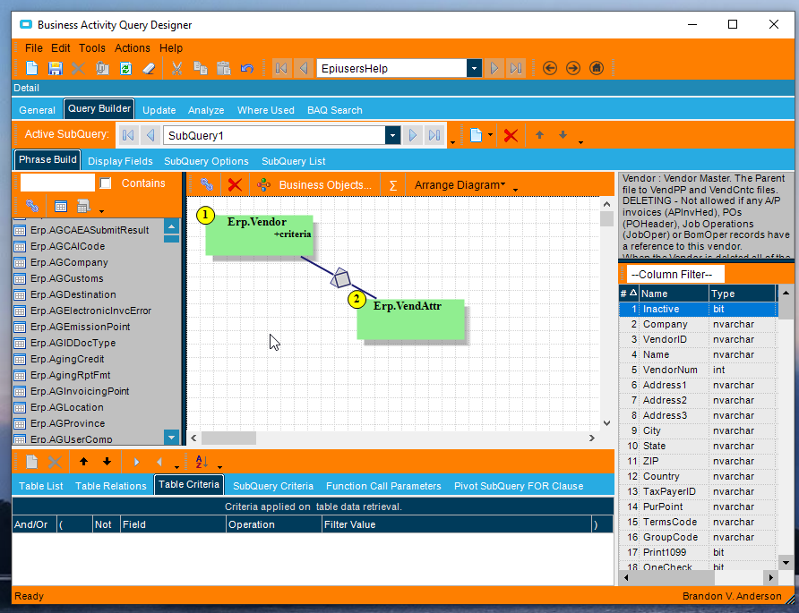

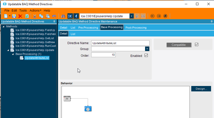

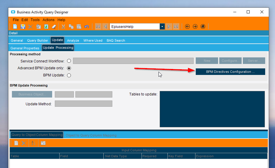

Brandon, here is my UBAQ:
I have no business object even selected.
Ah, I stand corrected. The way you cropped the BPM I thought it was on the main business object. Sorry.

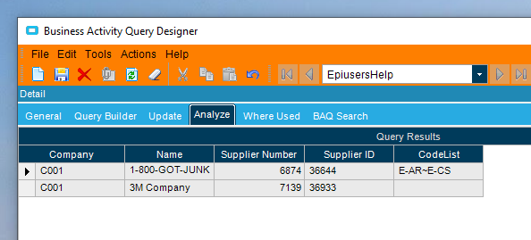

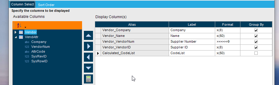

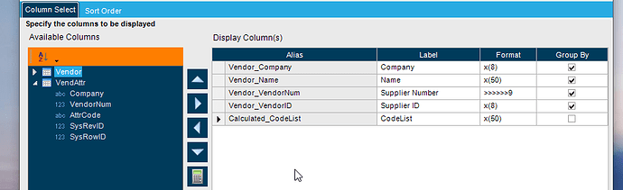

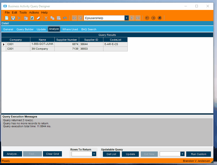

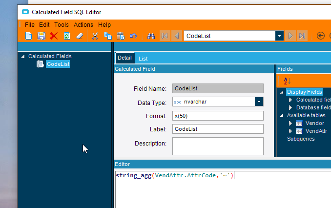

So here’s the BAQ that I used to get the fields in the right format.
I filtered down to 2 vendors. I added attributes to one to see what some values would be.

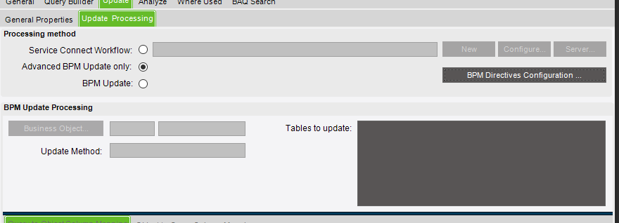

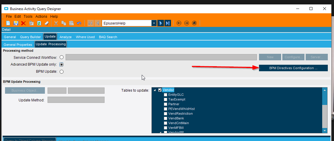

The BPM goes here in the advanced BPM update only

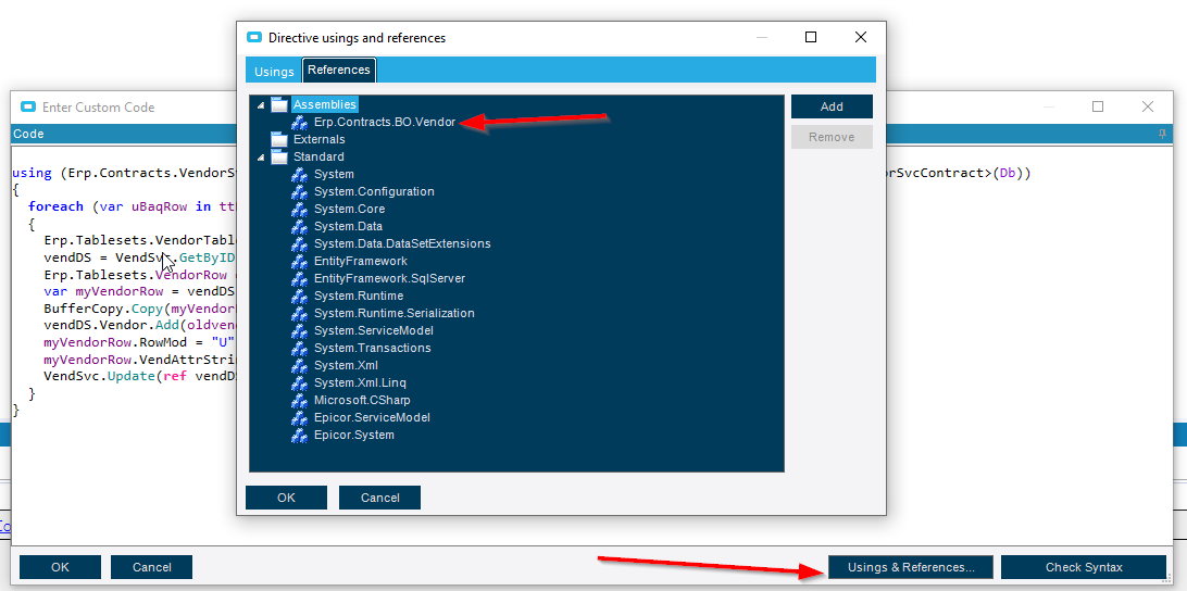

The first step is to go to the usings and references and add the Vendor BO.

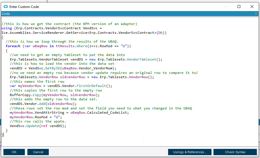

Here is the code that you need to do this with comments (it’s a screen shot so that you have to type it yourself and hopefully remember some of it :wink: )
So now you can add in a string, and update the record
Vendor Attributes
So the part that you will have to figure out is what you need the string to be to put in the field so that you can make the update. You can put this into a dashboard and do a paste update if you want to do a mass update.
