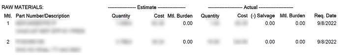

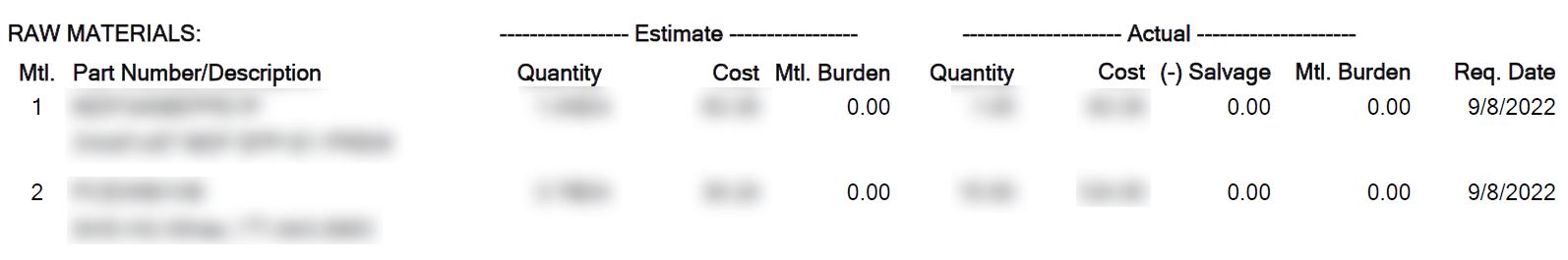

We are looking to build a BAQ that includes the material cost by operation.
The production detail report includes material costs separated by part which is a start. Is it possible to see the what tables/fields are being used to populate the actual material costs? Or is there an easier way to go about getting the material costs by operation?

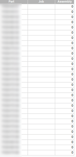

My only issue is I do not have any jobs or assemblies populate when I press analyze.
select
[PartTran].[PartNum] as [PartTran_PartNum],
[PartTran].[JobNum] as [PartTran_JobNum],
[PartTran].[AssemblySeq] as [PartTran_AssemblySeq]
from Erp.PartTran as PartTran
Part tran has a ton of stuff if it. So filter down to known job number to get your BAQ to return something. If you run it wide open, it’s gonna return a ton of unrelated stuff.

Any clue why I’m not getting any values under assembly?
Not without seeing some of your data. What does your job look like? 0 is a valid sequence number.

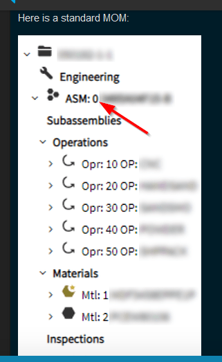

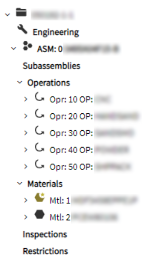

Here is a standard MOM:
Yup. Your assembly seq is 0. So 0 is correct. What are you expecting to see?

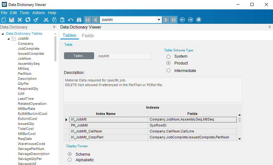

In phrase build there is no automatic link created between PartTran and JobMtl. Is there a middle or shared table I need to bring in?
no… Not everything is automatic. Stop and think for a second of you how you would need to join those two tables, should be pretty straight forward.
I’ve already manually linked them was just curious if I was missing something…
When I create manual links, I try to use an index and choose as many fields from left to right in my BAQ linkage:

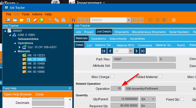

For analyzing job - I always recommend the Job Status Dashboard.
It is available as a right click off of the jobnum field.
The material list shows the related operation.
The material transaction tab does not, but could by copying the dashboard and modifying it.
