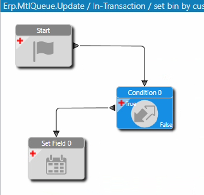

I would just do the update in transaction in a data directive. with a condition and a setter widget this should be a simple bpm.

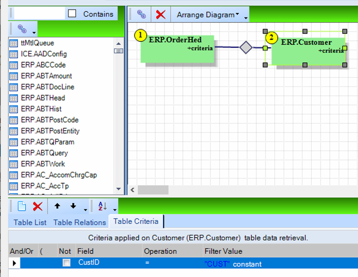

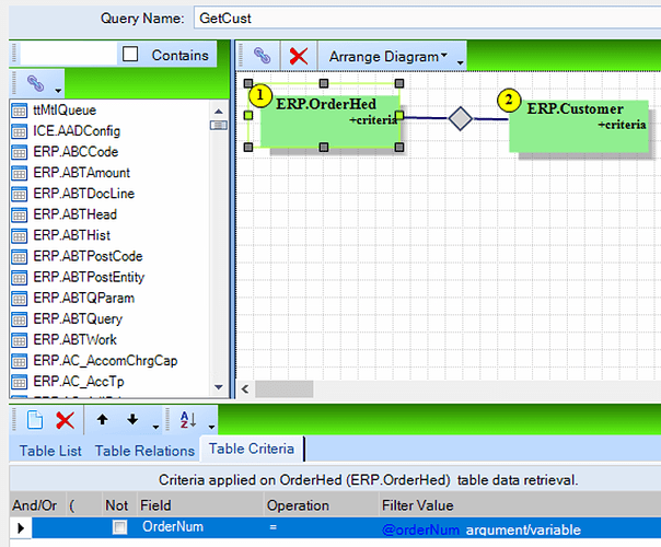

That is why joins were invented to take what you have and get what you need. You have OrderNum which has the CustNum to get the CustID.
set ordernum as a variable

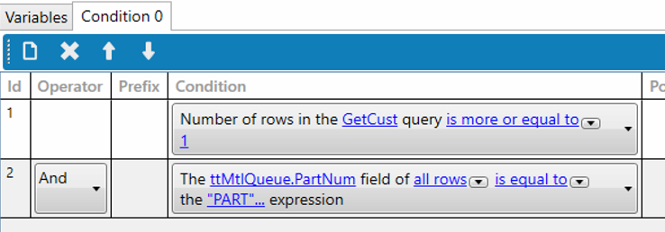

condition and setter
order is equal to the ordernum you set
cust is your customer ID

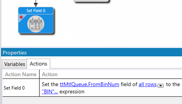

set the FrombinNum

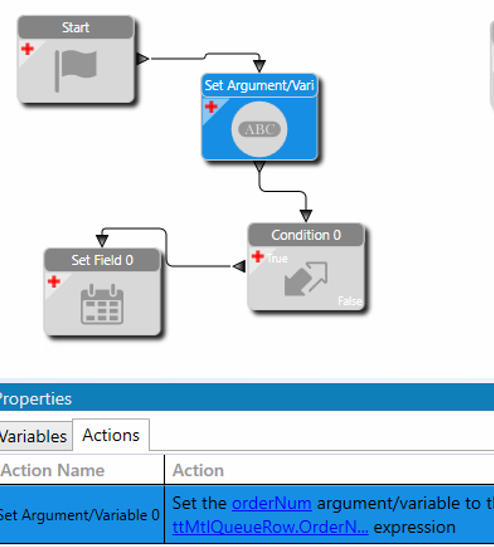

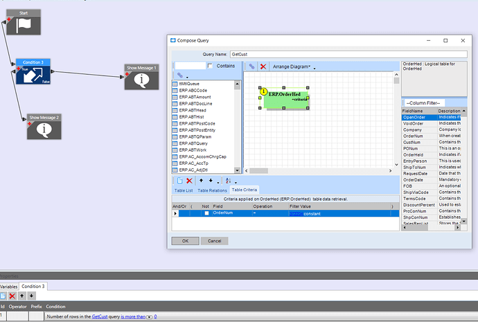

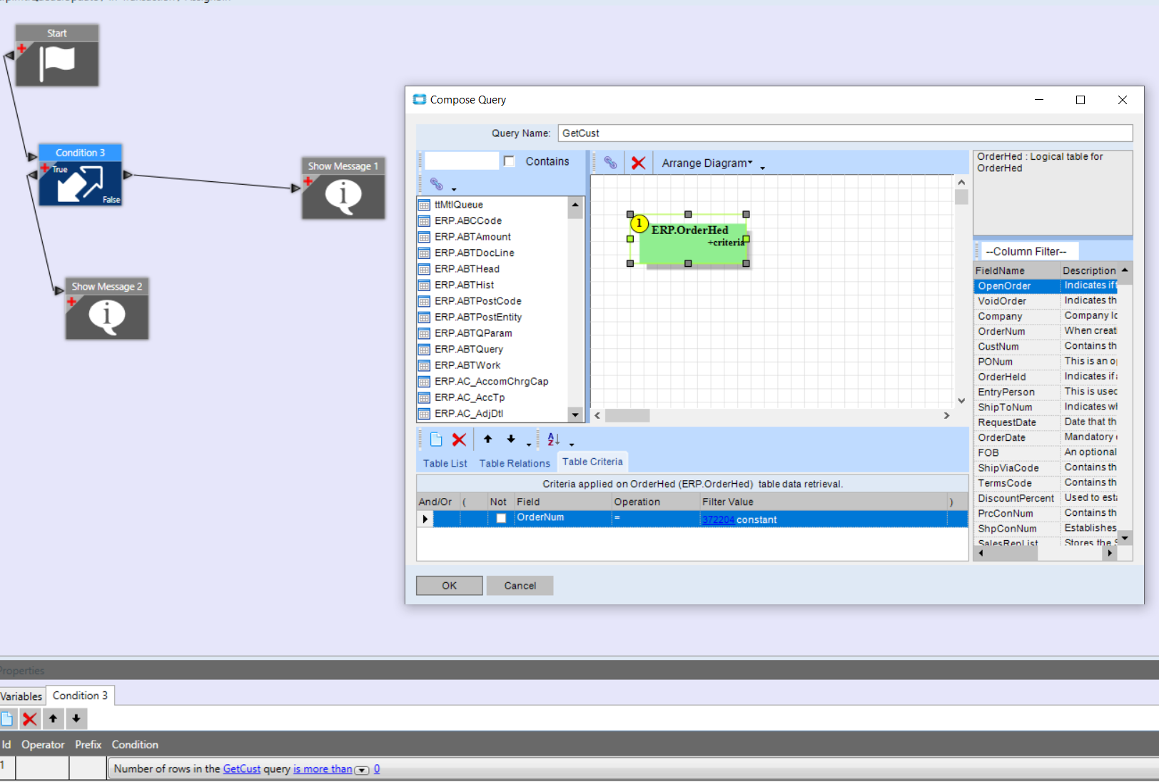

Thanks for the proposal but I am still having problems. I have scaled the BPM back where I am only trying to show a true or false message based on the order number. However, every order shows True when processing through the BPM no matter the order number.
You are not passing the current order so as long as the hardcoded order exists it will always return true.

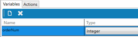

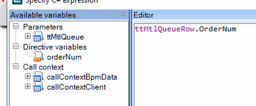

I missed a piece of the puzzle assigning the material queue OrderNum to the variable orderNum, so you have something to use in the customer check.
expression
