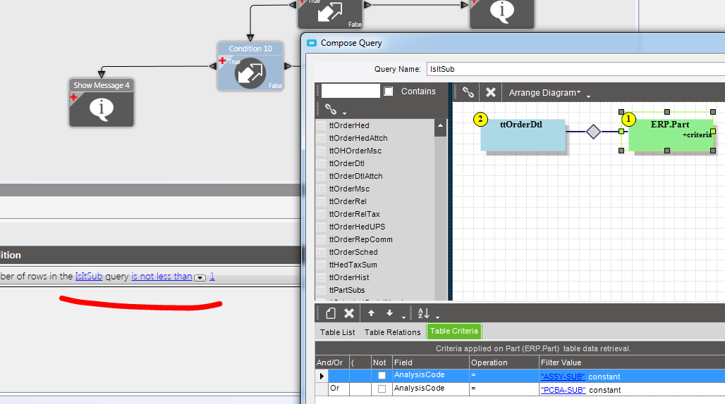

I can get this to work on a NEW line but on an updated line the BPM is not working correctly. My BPM checks for two Analysis codes in a query and should return more than one line if either of those codes is assigned.

The Query seems to be looking at what it was and what it becomes at the same time. I tried adding OrderDtl where Company=Company, OrderNum=OrderNum, OrderLine=OrderLine and added criteria on ttOrderDtl whereSysrowID<>OrderDtl.SysrowID and get an infinite wheel of death when saving.

Try setting a table criteria on the ttOrderDtl table in the Query where RowMod == “U” or RowMod == “A”. I believe method directives are passed an unmodified row and the modified row for the pre and post comparisons, so your query sees both the original row and the updated row and passes.
Also your Part is the first table and ttOrder is 2nd, change the order.
Thank you the BPM Speed article was the solution. Amazing and I’ll use that from now on. If I had only seen that 3 years ago! It would have simplified things quite a bit.
