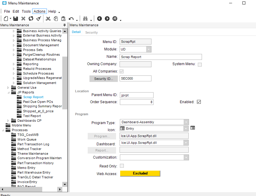

This is a custom SSRS report that is directly on the menu?
Can you from a screenshot of the menu item’s configuration in Menu Maintenance?
And if it is a custom SSRS report on the main menu, what is the default browser on the workstation where it doesn’t work? When a URL is passed from Epicor we use the OS default browser which could be the X factor.
Yes it is a custom SSRS report. I’m able to run it on my computer just fine going through Chrome, but the computer that it isn’t working on the default is IE11. I’m not sure what you want a screenshot of, I’m new to Epicor.
