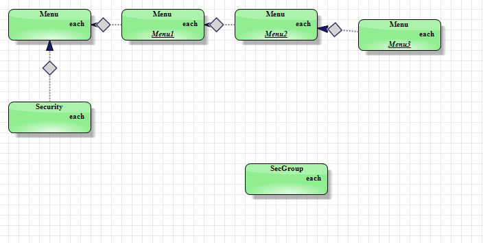

You need multiple copies of the table. Chain them together with:
  • table0.ParentID = table1.MenuID (outer left join)
  • table1.ParentID = table2.MenuID (outer left join)
  • table2.ParentID = table3.MenuID (outer left join)
and so on for how ever many levels deep you menus go.
BTW - the first instance of a table will just be the table name with no number after it. I used table0 to represent this in the above.

Start with the menu table. Just put it in once. Then add some columns (I’d suggest the menuid description and parentmenu) and test it. Note that those names are guess off the top of my head.
After you test it you’ll notice that the parent menu value for some rows is the menuid for one of the rows.
Now add another instance of the menu table (it will be named with a 1 at the end) and add a relationship between them connecting parentid of the first table to the menuid of the second.
Now add column for the description from the second.
If you test it now you’ll get what had before and now the new column shows the name of the menu holding the menu item. Like ‘Part’ and ‘Setup’
Ad the table again (name will end with 2) and relate to tabel1 with
table1.parentid = table2.menuid. Then add the description column from table2 and test it.
You should see the menu, its parent, and its grandparent.
Now go and add the second table and relate it to the secID of the first table. Then choose the columns to display from this new table.
Hope that helps

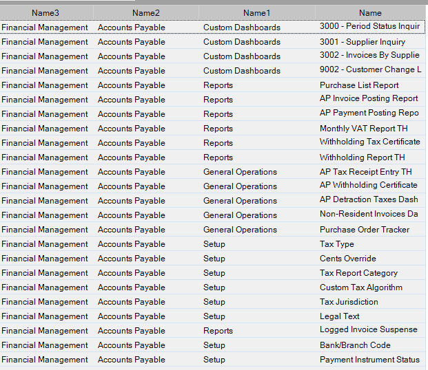

Hello Calvin,
That worked as you can see I now can display the structure.

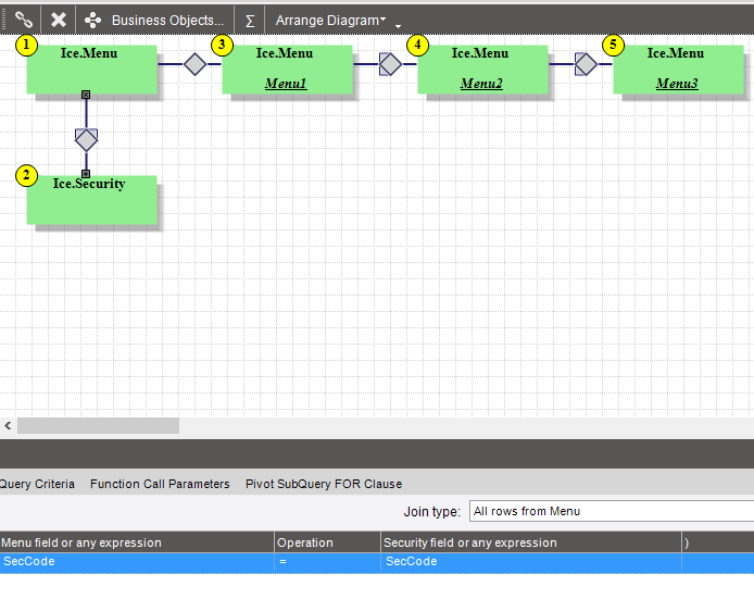

@RC2020, a BAQ setup like this should work. You should already have the top row of Ice.Menu just need the link to Ice.Security

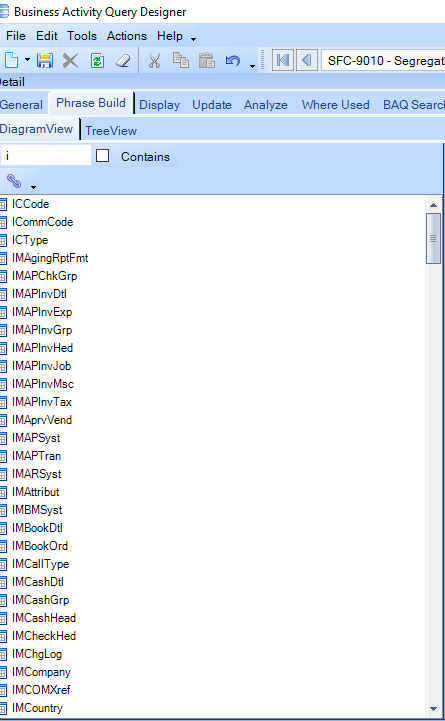

Hello Randy,
I don’t see ICE.Menu as an option (See my available selection below)
How to add the table in your example?
Thanks in Advance.
Miguel
You already have the Menu tables in your BAQ. Just add the Security table to the first Menu table
Hello Calvin,
How I setup the Table relations between the Menu and the SecGroup?
Thanks in Advance,
Miguel
Company to Company and SecCode to SecCode
(The field names might not be exactly those spellings)
Then add a columns from Security.
You’ll have to do some decoding of those security table fields as they will be combinations of checkboxes, and tilde separated strings.
