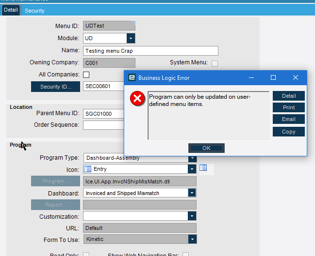

I certainly can confirm this issue. I was only able to workaround this kick to the “pick any painful place to get kicked” again by Epicor development, by copying an already existing UD “User Choice” menu item and just updating all the values before saving. My method allowed me to deploy a new and different Classic dashboard program. I was also able to change the Description of the source Menu Item, also a Classic Dashboard, and it saved the Description change without any problem. So, who knows.

Also wanted to put on the record that we’re on-prem and I was also experiencing this bug when we upgraded to 2024.1 a few months ago and I worked on converting all of our UD menus. I had to run a DMT to delete the menu, then another re-add it with the type changed to Kinetic. Wasn’t a terribly involved process, but certainly a lot more than choosing a different option in a dropdown and saving the record.
We are on-prem, for us it was us trying to change our own dashboard from Runtime to Assembly, the module was UD but it still kept throwing that error.

I’m coming into this a bit late, But is this the issue we are talking about? When I make a new menu, I can’t change the dashboard it’s using even if prefix with UD. I have to delete and re-create.

For me, it occurs if I try to change the Dashboard to an existing menu item.
