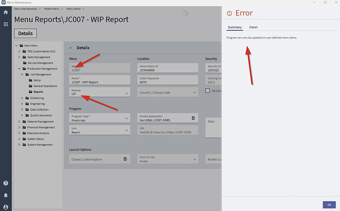

Now testing in my PILOT on 2024.1.5 I switch menu items such as Classic BAQ Report to a Kinetic BAQ report I get an error message "Program can only be updated on user-defined menu items. "

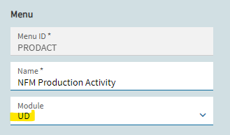

Yes I have the module set to UD but only items with the MenuID prefix of UD would switch. So test and confirm my findings, I would appreciate it.
Sounds like a bug you should report.

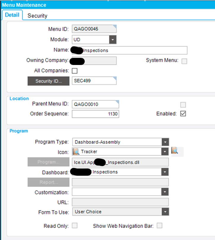

I have a similar but more disconcerting issue: A new menu item that was added in PROD shortly before we took a copy into TEST and upgraded TEST to 2024.1.5 is completely missing from the database. I have a ticket open, but I was wondering if anyone else has seen this?
Yes, I have had similar issues. I had a menu item get switch to a different parent.
Try a BAQ listing all menu items and see if QAGO0045 is listed somewhere else.
or Just try a menu search that may be the easy way.

It is completely missing from the database. I ran a data compare on ice.Menu between TEST and PROD.

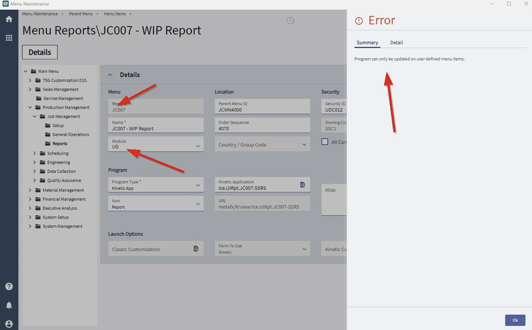

I just came across this same error message so I opened a ticket to see if it was something on my end. Looks like its a known issue on:
PRB0284041 - Menu Maintenance error when making a change on existing UD menu and saving – Error: Program can only be updated on user-defined menu items.
Epicor supports response was to take note of menu settings, delete menu and recreate from scratch.
