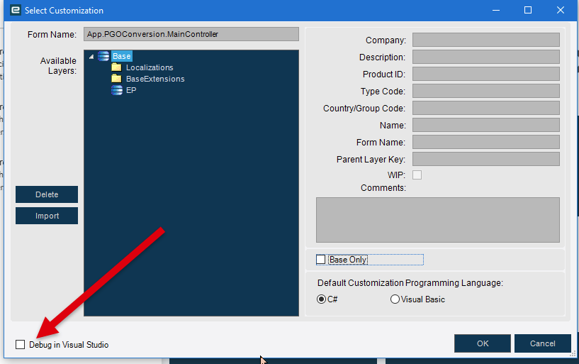

In developer mode, there is a checkbox for “Debug in visual studio” in the bottom corner. Check that box before you open the form and it should open visual studio and start debug mode.
Not having a good day here…I don’t seem to see that option? I am in the customization window but I don’t see that checkbox?
You don’t see this?
Ok so I was looking in the wrong spot…rookie move…however, it seems that while the checkbox is there its disabled…I have Visual Studio installed but perhaps a setting I need to change? Sorry for the hassle on this
I was worried about that. There are some registry settings that can get messed up and I always need help to fix it.
So let’s just skip that.
