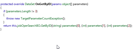

Ah, i believe this might be the issue… Looks like the GetByID for that adapter requires three params
which translates to:
So to use the GetByID on that particular adapter, you need something like:
adapter.GetByID(new object[]{“job”,assySeq, opSeq});
