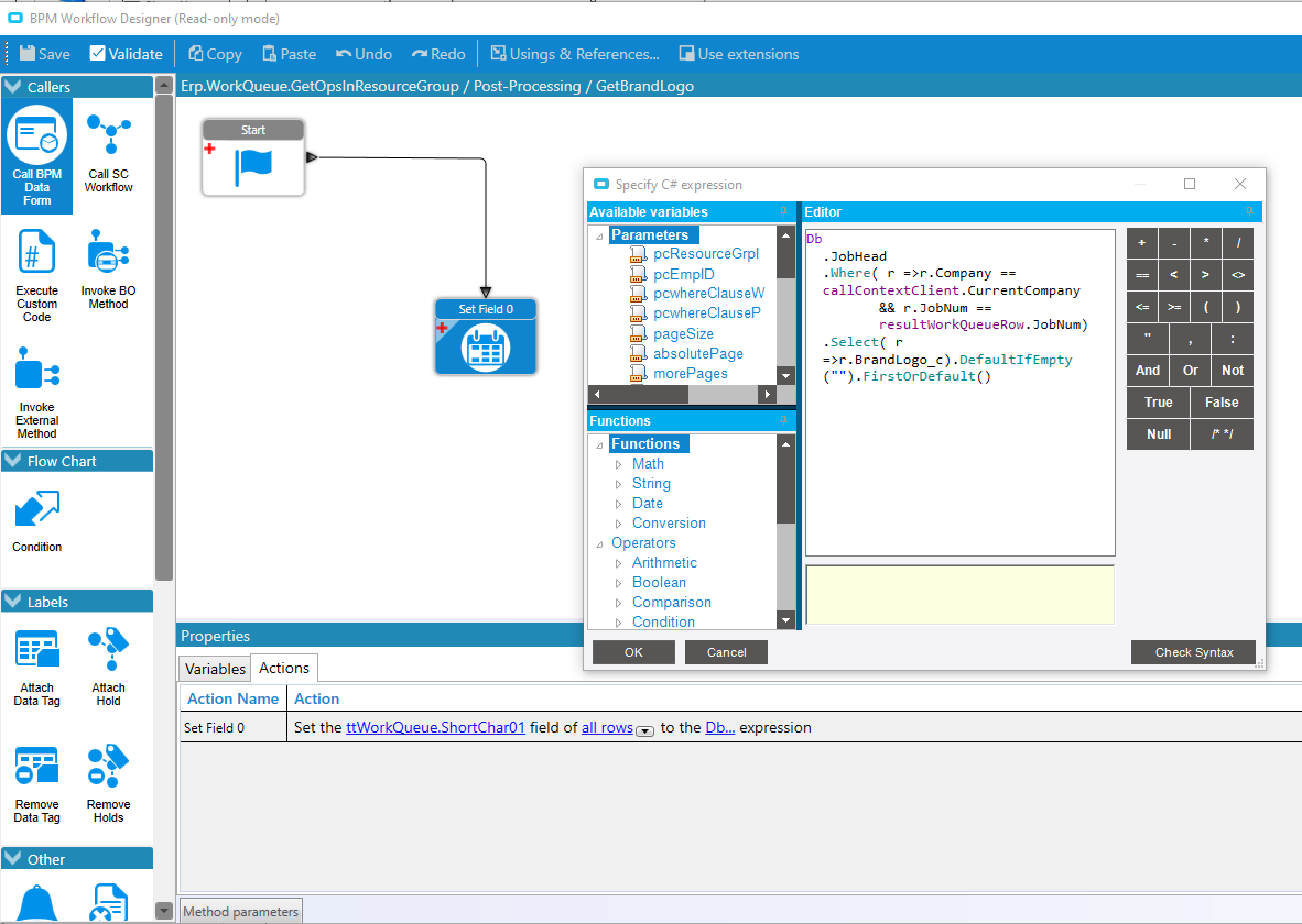

Here’s a screenshot of the post-processing BPM I created on WorkQueue.GetOpsInResourceGroup. It copies the value of my UD field to ttWorkQueue.ShortChar01.
Then I customized the WorkQueues to add the ShortChar01 field.
Perfect thank you so much.
