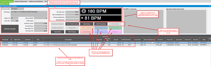

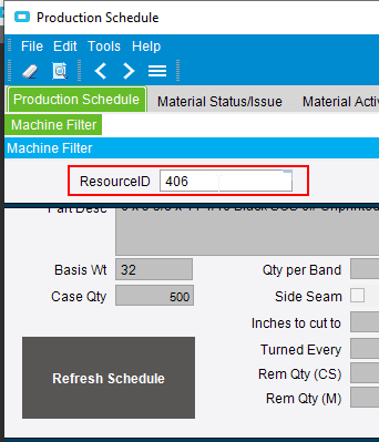

Similar to others we made a single pane for most operations. Each machine has a dedicated filtered UBAQ.
The BAQ auto loads and refreshes it knows what resource ID to filter on based on PC name. Computer name is something like (MES406)
You can manage job in and out data collection all from the main tab

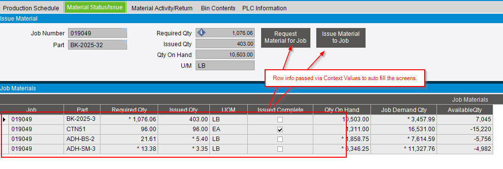

They can issue material (only from the resource bin locations AMM) or request material delievery on the queue

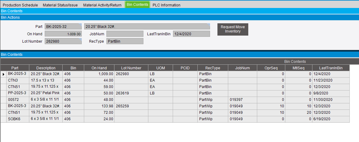

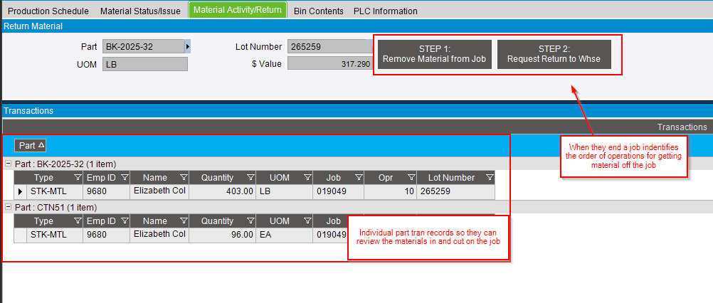

Return material to their resource bin and stk-stk requests to get mtl back to the warehouse are handled from another tab
We allow them to view what the system thinks is at their machine not on the job and if need be select a material and request that the whse pick it up

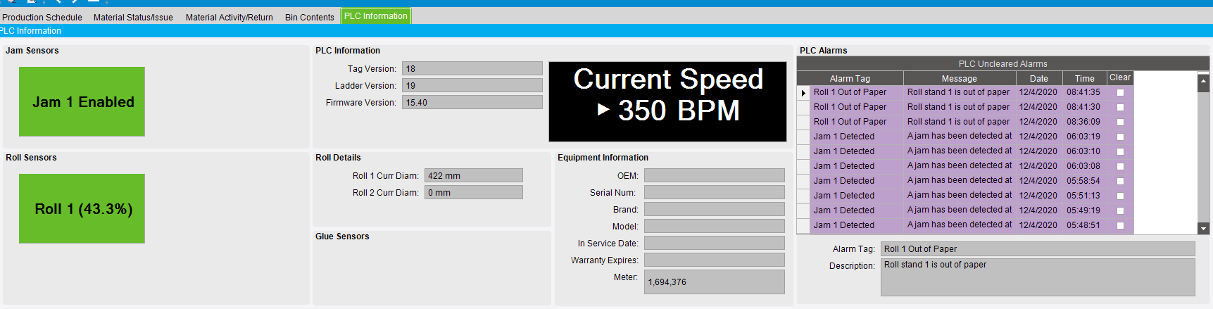

Finally MATTEC style information from PLC data and Epicor Equip records

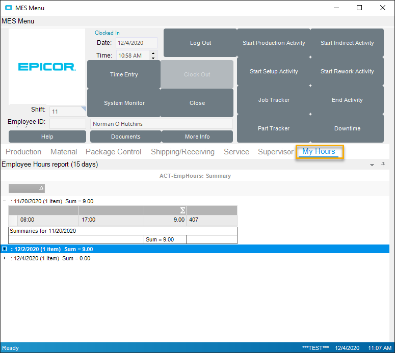

My Hours Tab - a tab displaying the current employee’s last 14 days of clock-ins and outs.

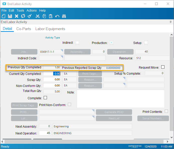

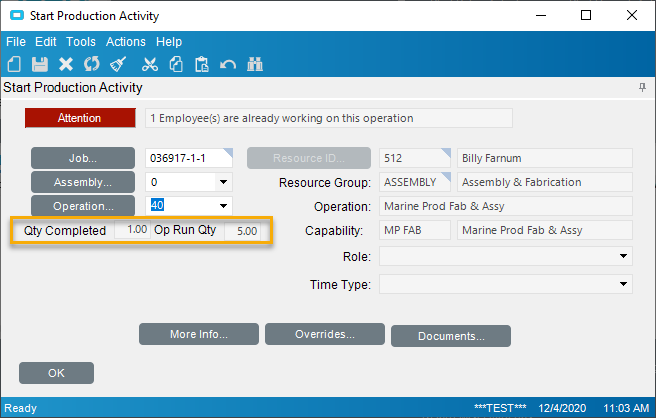

Display Previous Quantity Completed and Total Run Qty on Start Production and End Activity.

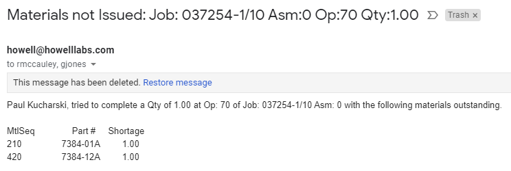

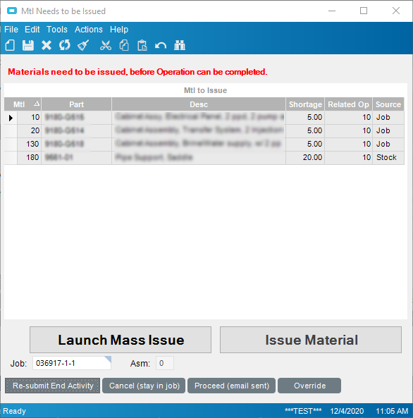

Stop Operations being marked as complete if related materials have not been issued.
We require the employee using parts to pull them and issue them in Epicor. One way to enforce this was to create a warning window; listing the outstanding mtl when an employee attempts to complete a qty on an operation.
If they get this message, they have a few choices:
  • Launch Mass Issue with job number prepopulated to resolve the outstanding mtl issues.
  • Launch Issue Material with job number prepopulated to resolve the outstanding mtl issues.
  • Re-submit End Activity to see if the mtl issues have been addressed.
  • Cancel which cancels the transaction and leaves them in the job.
  • Proceed this allows them to end the activity without completing a qty. If also emails the supervisors to let them know there was an issue.
  • Override prompts for a supervisor password to override the material issues and complete the qty.

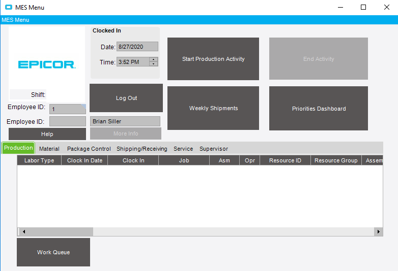

Ours is out of box 10.2.1 MES and it annoys me how difficult it is to customize if you have no C# experience.
We only track clock in/clock out and hours on job/operation, so interaction with the MES is minimal. We should have a simpler screen.
You can simplify the MES interface without using any C# at all. In Customization mode, select a button you don’t need, then in the Properties window, set one of the size dimensions to 0. (Epicor won’t let you delete the standard UI elements, but you can make them functionally invisible.)
Here’s our simplified interface (still a work in progress):
No C# was needed to “remove”/resize/rearrange the buttons. And only a single line of C# code was used in the Event Wizard on a button click event to open other applications based on their Menu ID:
ProcessCaller.LaunchForm(oTrans,"MENUID");
