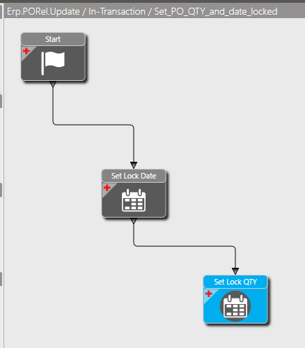

I am attempting to auto check the PO Release Lock Date and Lock Qty checkboxes when a new PO Release is created. I was successful in creating a Method Directive for GetNewPORel which checks both when using File > New > New Release.
My issue is when I first create the PO line and the initial release is generated at save - my Method Directive does not work. I got around this by adding a Data Directive to set these but wondering what I am doing wrong with the Method Directive. Any Thoughts?
Sreen shots of the Method Directive being used:
It just doesn’t look like the GetNewPORel method gets called when a new line is added. The release gets made from some other method. Maybe GetNewPODetail creates it, not sure.
I am using the following data directive:
