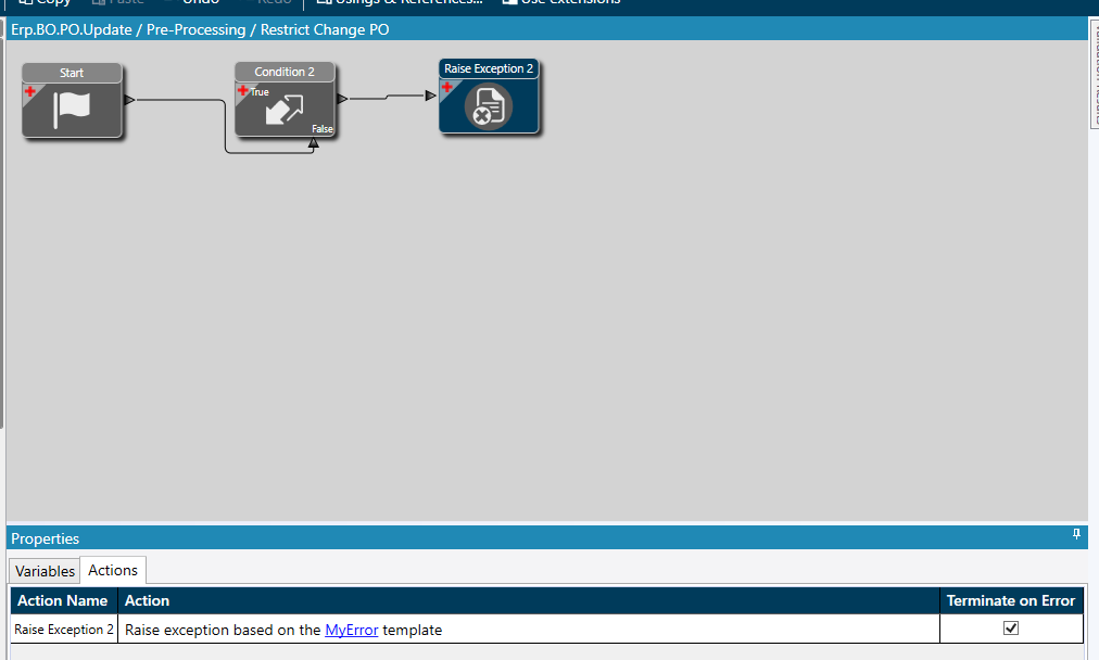

@lbradbury it would look like this
Method Directive, PO, Update, Pre-Processing

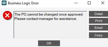

This is the error message the buyer would see.

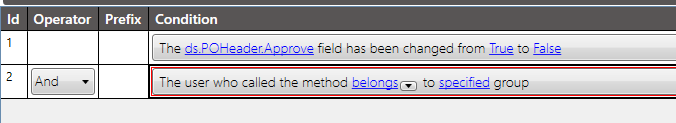

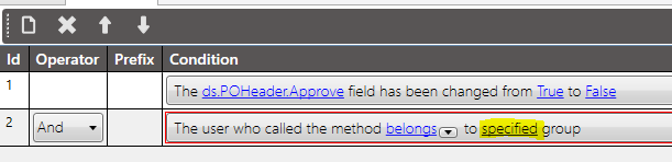

If I understand correctly, you want to know where to apply which group cant change the approved status on the BPM?
Select “specified” and pick which group you want.
If you’re wanting to see which users belong to which group, then once again @jgiese.wci is correct. At the user level they get assigned groups on Security Groups and User Account and Security Maint.

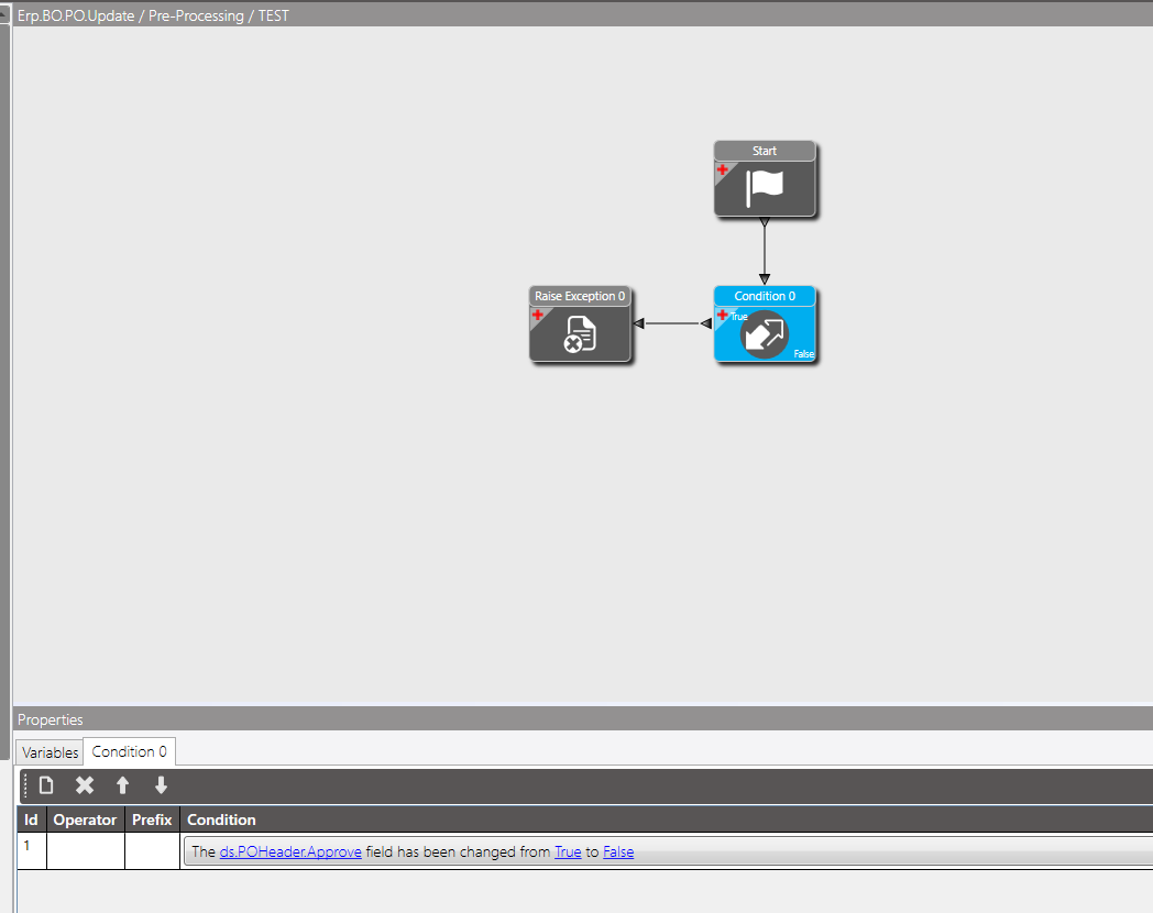

One more question. When I test this, the PO still un-approves. and the buyer can make edits.
Thanks for any help you can provide!
Is the Method Directive set for Pre-Processing? If so, when you hit refresh, it will return to approved which should prevent edits.
Mind sending a screenshot of your BPM?
Sure!

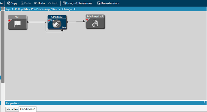

I cant see the condition on that widget but when I wrote my example, I had it set to raise an exception when it was true like this:
You may just need to move it to the other side.
