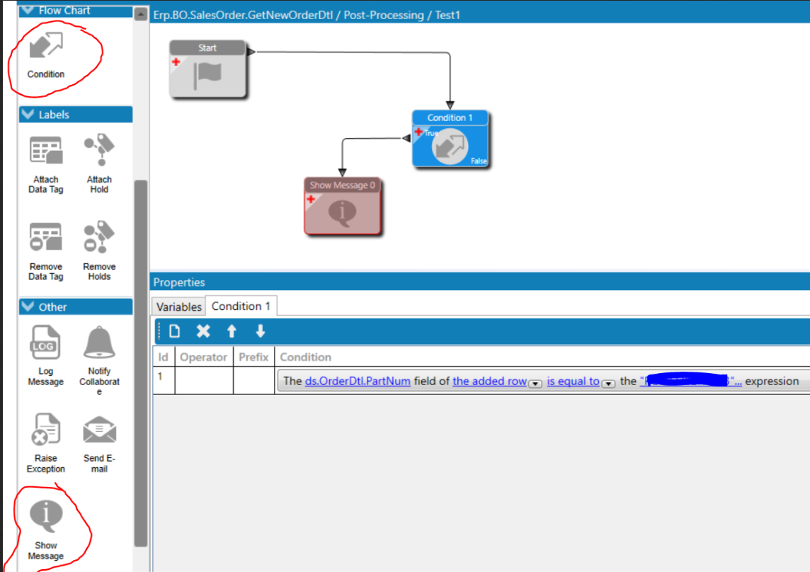

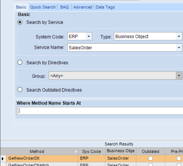

Open Method Directive and search for Service Name: Sales Order, where method name starts with GetNew and find GetNewOrderDtl.
Then add a new Post-Processing directive, name it whatever you want, give a description, create a group if you want (or select an existing group), if you are multi-company you will have to decide if you want this to work in 1 company or all companies. Click the design button.
Drag a condition widget onto the workflow pane, click on the widget, add the condition “The specified field of the changed row is equal to the specified expression”. Click the specified condition and select de.OrderDtl.PartNum, leave the added row, leave the is equal to, click the specified expression and use quotes around your part number that you are looking for.
Then draw a message widget into the workflow pane. Click the designed template and type whatever message you want to pop up.
Connect the start box to the Condition widget. Connect the true output of the condition widget to the Show Message widget. Validate if you want or just save and close the design window.
This is an easy BPM to do.
