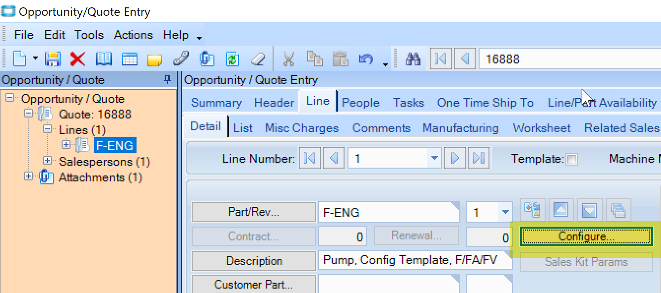

Just to put this out there, in case you are not aware, can you use the configure button on the Quote Line to get your part master part with unique number? We do this on our sales orders. We do not actually use the configurator for anything except automatically creating a new part master record with plant / warehouse.

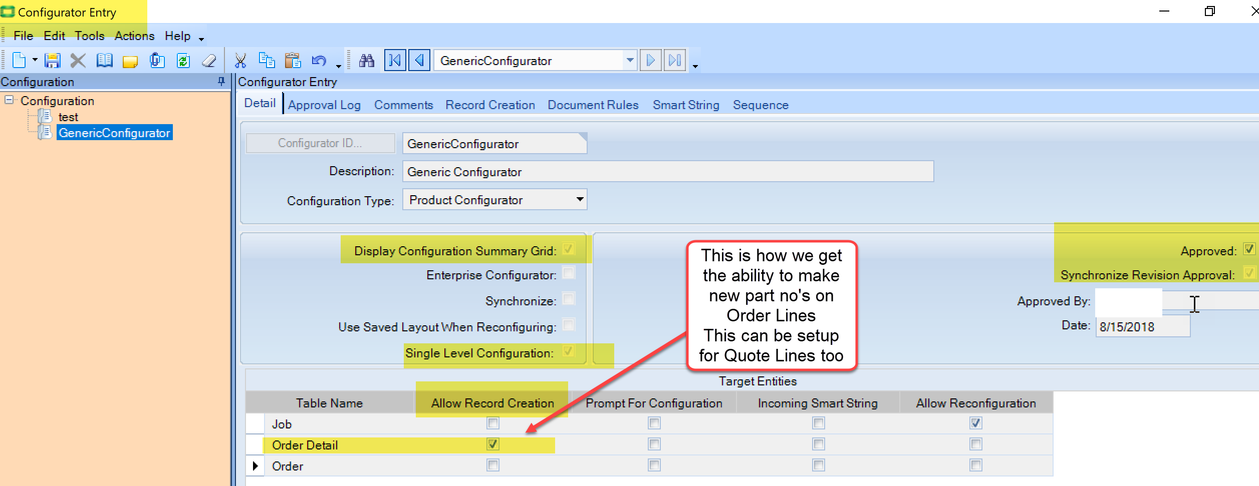

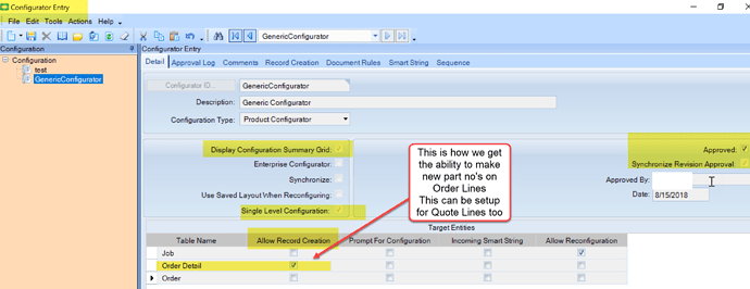

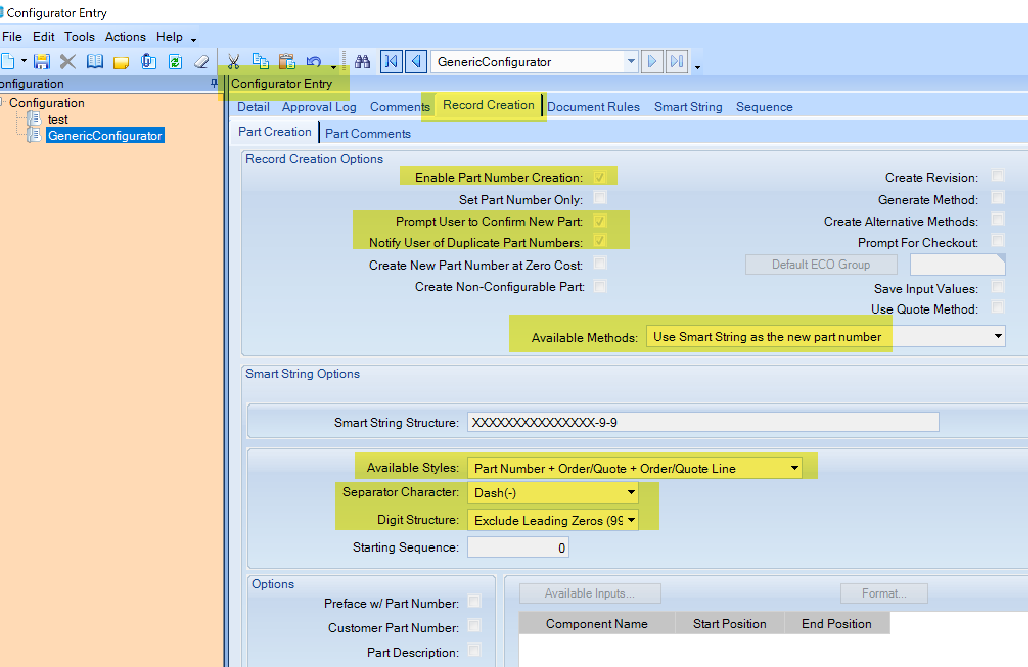

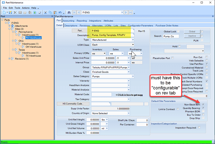

Ok, so we do not do this on our quotes, but we do it on sales orders. As per above screenshot, it may be setup for Quotes, and the configuration entry below will show that with the “Target Entities”. First, we have part templates that get copied. Our configured templates are based on product lines of R, F, XG, etc. We have standard product part numbers in these product lines so because these will need configuration we call them R-ENG, F-ENG, XG-ENG. See below for part setup for one of these part master templates, F-ENG, tied to our “Generic Configurator” to get part added to part master when configure button clicked on sales order, also per below. It might look a little complex, but once setup it functions nicely for this need for us.
Configurable part no setup in Part Master:

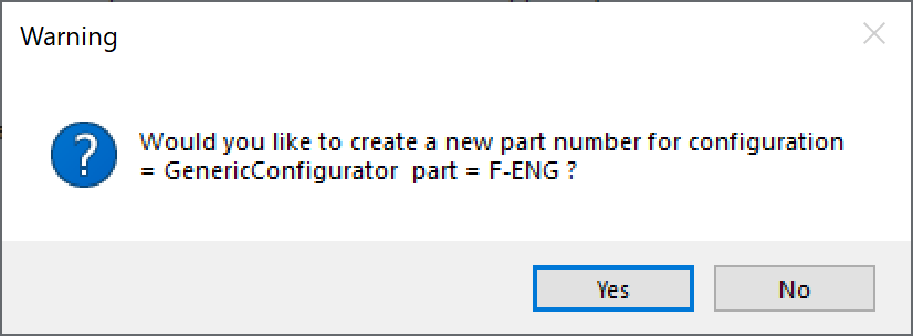

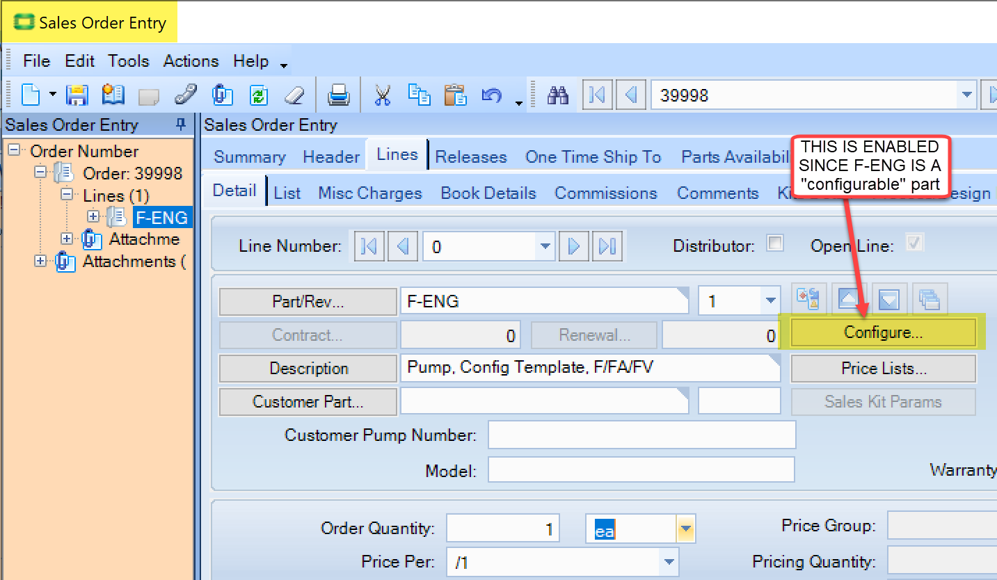

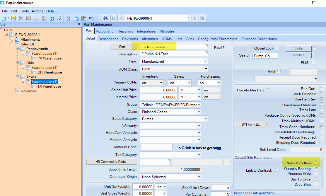

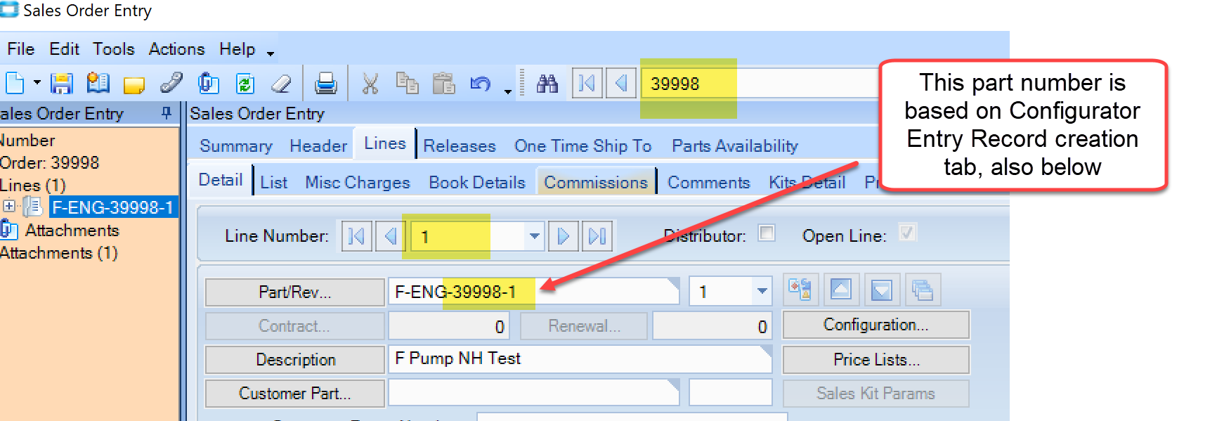

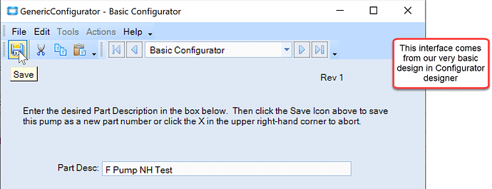

When placed on a sales order, enter quantity on line, then click Configuration button, see our Configurator designer layout (also shown further below) and click save. Get new Part in part master with our plants and warehouses… note, you can get it to make a rev too, we use no rev as a hold for work point so don’t do that today:
Back in Part Master, I get duplicate record for the F-ENG but called F-ENG-39998-1. Note it did inherit the req’d (because configurable part F-ENG needed it) Nonstock flag but I am able to now save it unchecked. If this was needed, a BPM could be done to do this… my Part Desc from Sales Order save doesn’t work, and I use a BPM to put it on the new part record in part master after configurator added it.
Now onto the configurator. There’s configurator entry and configurator designer. Here are our settings for it. I am far from expert on it, but these work fine for us to date. When you do a new Configurator Entry you get the ability to see more “Target Entities” (e.g., Quote dtl) than seen in our target entities, for places where you want configure button enabled.
