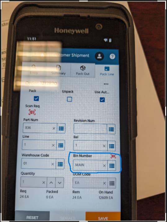

When we scan a barcode in, we want the primary bin for the part to be displayed. Right now, I am seeing MAIN as the bin. MAIN is our floor and the default in Company Configuration under shipping and receiving.

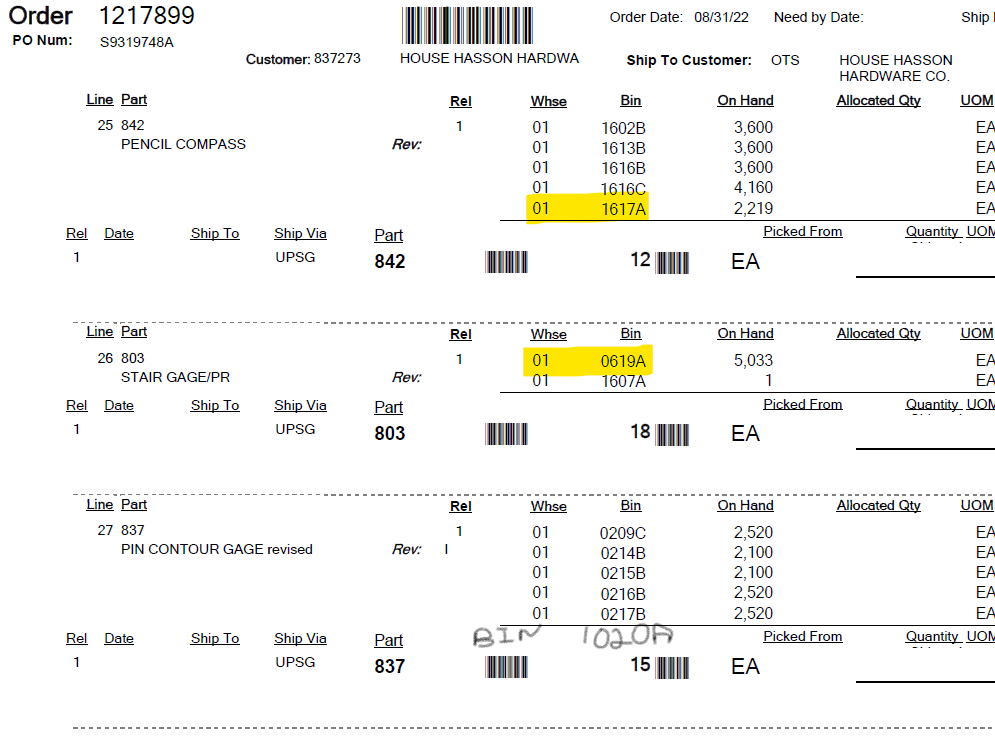

Here you are @GTI07094 , an example of what I was talking about. Thank you @tsmith for going more into detail!
@tsmith - we are using pack out for carton integrity, but that is where I am seeing it default to main on each pack line. Correction through to my previous state as its under site config where the default value is. The primary bin is what my team wants and not what I am seeing “We use Pack Out and found that it was defaulting to the primary bin”
@utaylor I dont see an example
at packout/Packline

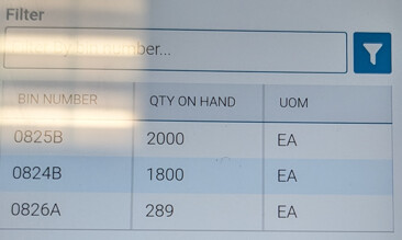

and then what I see when I click on bins
