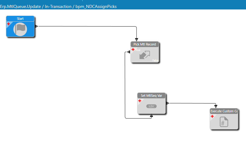

I’d love to see that BPM - which object is it on? MaterialQueue?
Hi, The main issue with this thread ended up being a bug in Fulfilment Workbench. If you print a pick note it failed, if you pressed no do not print then this worked a dream.
BPM below.
CustomCode block below.
foreach (var MtlQueue in (from MtlQueueRow in Db.MtlQueue.With(LockHint.UpdLock)
where MtlQueueRow.Company == Session.CompanyID &&
MtlQueueRow.MtlQueueSeq == MtlRecord
select MtlQueueRow))
var zone = (from mtlQueue in Db.MtlQueue
join whseBin in Db.WhseBin
on new {mtlQueue.Company, mtlQueue.FromWhse, mtlQueue.FromBinNum} equals new {whseBin.Company, FromWhse = whseBin.WarehouseCode, FromBinNum = whseBin.BinNum}
where mtlQueue.MtlQueueSeq == MtlRecord
select whseBin.ZoneID).FirstOrDefault();
if (zone == “CAR”)
MtlQueue.WhseGroupCode = Convert.ToString(“CAR”);
else if (zone == “BOX”)
MtlQueue.WhseGroupCode = Convert.ToString(“BOX”);
else if (zone == “SING”)
else if (zone == “PAL”)
MtlQueue.WhseGroupCode = Convert.ToString(“PAL”);
