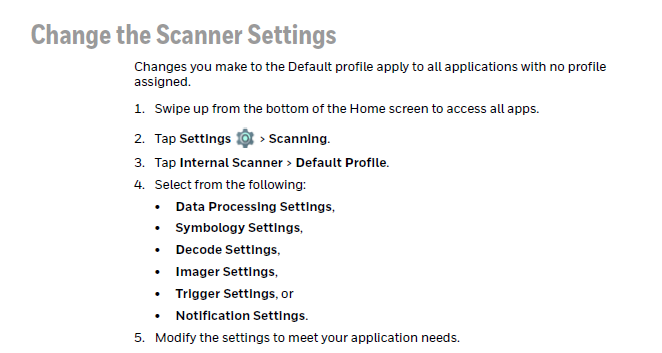

@sspiewak - I got code 93 to work. You have to enable it. Here’s how.
Thanks Chad,
I was able to follow your instructions and enable CODE93 in the EMW app, however it still will not scan our barcodes in the app. When I open a google sheets file, it will scan them no problem. Something is preventing it from scanning in the app. It seems to be a tough topic to find support on. I appreciate your help, I thought for sure that was going to solve it.
