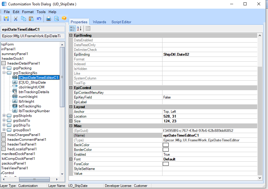

I was asked to add a UDF on the Customer Shipment screen, I added Date03 to the screen. But now the shipping department wants this UDF to be able to enter date although the shipment has been invoiced.
Does anyone know I can make the UDF field accessible within the same screen?
@RC2020 The only way to do it on the Customer Shipment Entry screen is to not bind it to ShipHead and then on update slide it into the field to be saved.
Build them an UBAQ with an advanced update in ABL that will work now and will work when you convert up to E11.
You would not bind it at all, then on a LostFocus event you would update the dataView field, so it could be saved.
private static void numLTQty_LostFocus(object sender, System.EventArgs args)
edvEnd.dataView[edvEnd.Row]["LaborQty"] = numLTQty.Value;
