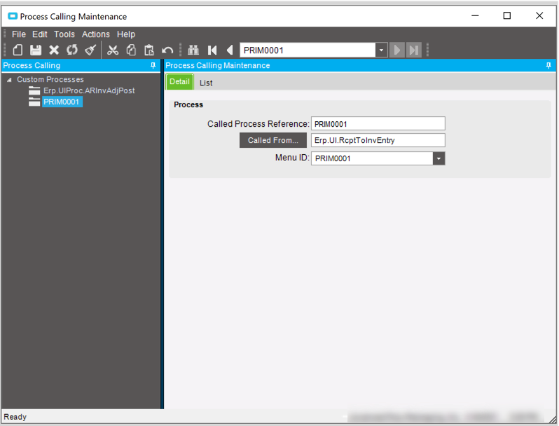

  4. We added a processing calling maintenance entry that looked like this:
Then after restarting the client it seemed to work as expected. If I had to guess what was going on, even though the process calling menu entry before was pointing to the correct customization (and we could see that it was supposedly running it via Help / About) that it would ONLY load a customization named the exact same as the original launching form. Anyway, I’m keeping my notes handy as I suspect this is still some form of bug that will ultimately get fixed and require revisions here.
