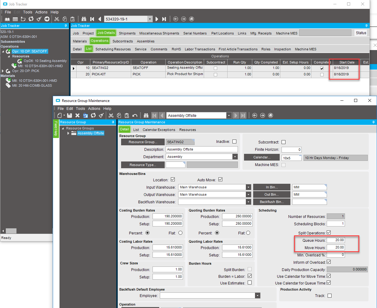

We have a production calendar that’s set for M-F for 10 hour days.
On some resources, we have a move and queue time of 20 hours each, so 2 days before the op, time to do the op, then 2 days after the operation.
Yet–when I look at this job that was scheduled by MRP with a start date of 8/16/19, the operation with those move/queue times is starting and ending on the same day (prod hours is only 0.20).
What happened to my move and queue times?

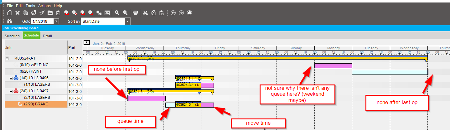

If you look at the job scheduling board, it looks like it doesn’t put any queue time on the first operations, and not move time on the last operations. So your start time for a 2 operation job. So your first operation isn’t adding any queue time. (which I think we both agree is asinine, considering most people are really using queue and move time to pad schedules because everyone knows things don’t go instantly from one process to another)

@Banderson - I agree on the reason the queue time is not there for the first op, but the first op also has a move time of 20 hours, so it should have that 2 day gap before the pick operation starts, no?
@E102016 - Scheduled before the operation was completed.
@amaragni - All of our operations are set to Finish-To-Start

what is the move/queue time of the RESOURCE?
They’re set to “Use Resource Group Values”.

also (i agree with bandersen) try looking at the job scheduling board to get an idea if the system is “seeing” the M/Q/ time.

You are correct Al, the system, at least on 10.2.700 is not honoring the ‘use resource group values’ box.
