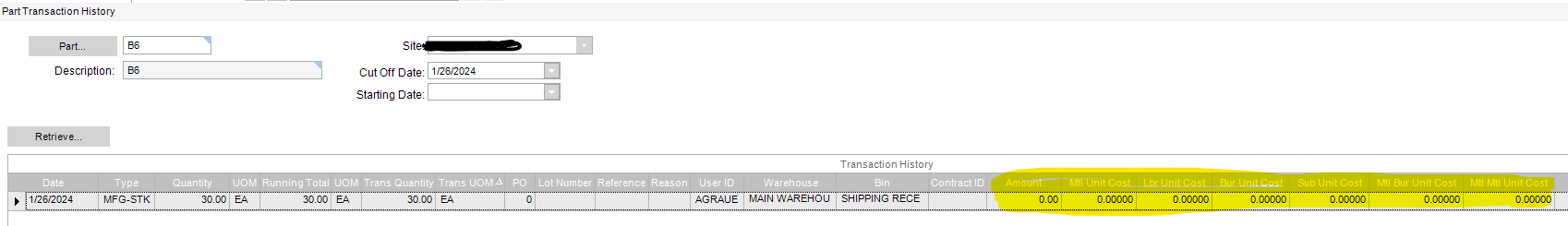

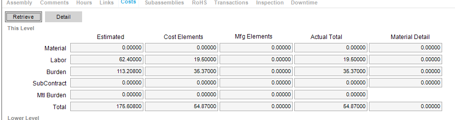

We made a job to inventory with a production qty of 1. The sub-assemblies on this job need to be issued to inventory to be issued to production jobs. I have that part down. The job/quantity were marked as complete and issued to stock (MFG-STK). Then each assembly is being issues to stock (MFG-STK). The issue is that I am not seeing any of the labor and material costs moving with those parts. I would expect to see the costs come off the inventory job when the sub-assembly is issued to stock but it is not. Our company config for parts is STD and so are all the parts. What am I missing that needs to happen to fix this? Screen shots below show that the costs on the sub-assembly are the same before AND after issuing them to stock and the other is the sub-assembly parts in inventory with no costs associated with them.
