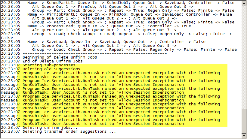

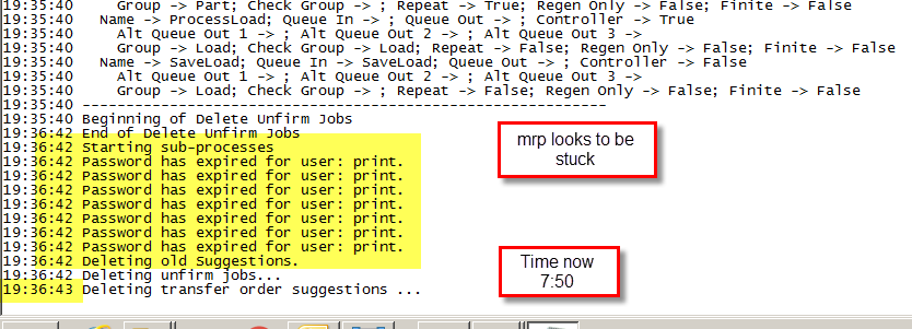

Do you have any information in your MRP logs? When we were first testng E10 we had same problem. It did have to do with our print account password being expired unexpectedly upon upgrade… The account also needs allow session impersonation to be clicked. Here’s what our logs looked like for the two errors. Once fixed we were good to go.
