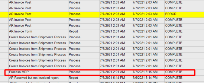

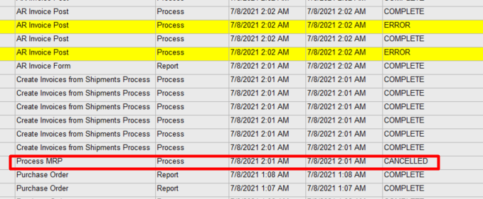

Here are the system monitor entries surrounding two recent examples; one that was cancelled and one that completed successfully. It’s possible that the BPM directive ‘Create Invoices from Shipments Process’ sometimes plays havoc with MRP and should be scheduled so as to not overlap. Am I on the right track?
(cancelled)
Screenshot_2
(complete)
Screenshot_1
Sometimes I might try to simulate “suspect” situations manually?
Do you have a test system you can play in?
e.g. can you trigger your BPM and while it is active - try to submit MRP for processing?
MRP might throw an error message if that is really the conflict.

@BillCox I would say you are on the right track. I recently found out that to make sure one process is complete before another is to put them in the same process set and not to check the allow simultaneous processing. I was doing MRP Recalc and MRP in the same schedule, but both would start at the same time so recalc was not finished when MRP started.
Odd how it starts at 5:15 or 2 on different days.
Check to see if you have another process MRP running concurrently.
