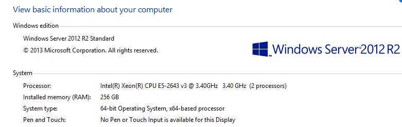

Server:

Hyper-V?, Physical?, VMWare? QNap, NetApp, SSDs? Any Network Changes to Firewall, Hardware, VMWare, Cisco?
Physical. logs are on SSD, database on Fusion IO card.
