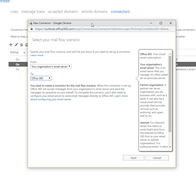

That is it for the Server side of things. Next we need to setup a receive connector in Office 365. You need your external IP address (http://ipquail.com). Login to Office 365 as an Exchange Admin. Head into the Exchange Admin for your Tenant. Then ‘Mail Flow’ and ‘Connectors’
Add a new connector. Select From: ‘Your organizations email server’ and To: ‘Office 365’ Click Next
