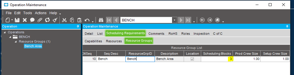

have you tried changing the scheduling blocks at the operation level instead of resource group level
Yes, when we tried that it allowed the scheduling engine to assign 2 blocks of schedule to an individual resource, rather than assigning multiple resources to a single block.
so what i meant is, you can assign the needed no. of scheduling blocks at operation level, thereby each operation will call the relevant required number of resources rather than fixed no. when assigned at resource group level, and this should solve your issue
