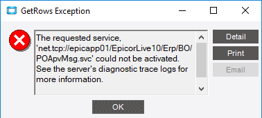

I did an upgrade from 10.1.600.5 to 10.1.600.20. I ran through all of the conversions successfully, ran my local Client as Administrator and had it update, but as I’m verifying everything by opening various modules, I’m seeing error after error that looks like this (with many different *.svc errors):
svc_errors
Any idea what might be causing this type of error? I’ve bounced Application Pools, Recycled IIS, (Reinstalled) and bounced ICE Task Agent, Rebooted SQL and App, nothing seems to work. Any thoughts?
