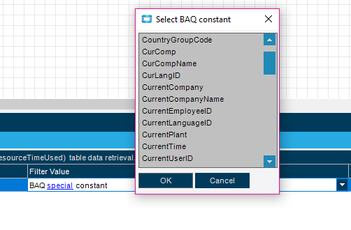

You could just put a BAQ criteria to CurPlant
Thanks, that did the trick. :slight_smile:
