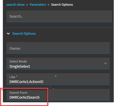

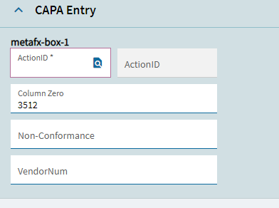

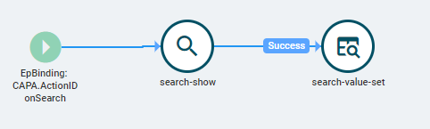

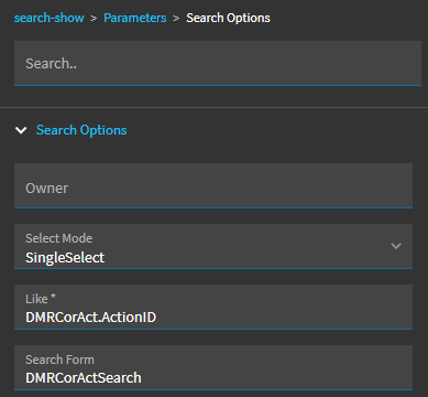

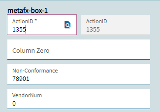

I created a new application studio dashboard, created a text box with a key field and search, and then edited the on search click behavior on the text box.
In the event, I added a search-show action and successfully pull up my quick search. Then “On Success” I tried pushing the result back through with the search-value-set action.

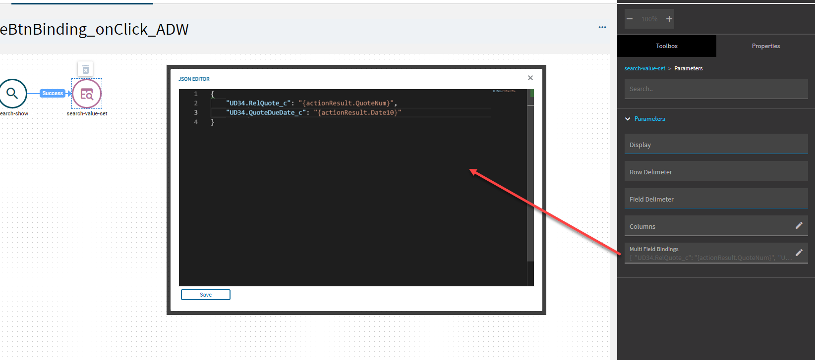

I’ve attempted to implement identical to the below post on using Search-Value-Set, but it doesn’t seem to return anything to my fields.

Search-Show
Search-Value-Set

Essentially, it searches and I can select a record and hit OK, but it doesn’t close out, and it doesn’t fill any of the background fields in. I recreated it from scratch a bit ago and recorded this for a visual:
Anyone see anything glaringly wrong with my setup, or do I need to do something additional to make it leave the window and populate my dashboard fields?

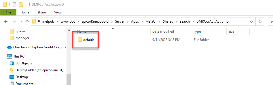

Did you implicitly create this search form?
Otherwise, it should just be default.
I mistakenly assumed they all had a default search named like that. You are correct :slight_smile: 1 step closer, it returns from OK but empty. Looking over everything again to see if I tweaked anything trying to make it work. I will let you know if this was my magic bullet!

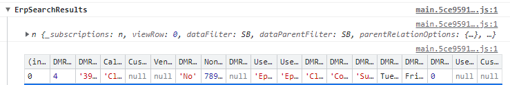

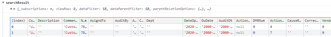

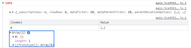

Seems my searchResult table is getting filled with all of the records and not returning only what I select.
Is that standard/intended behavior? The view row is always showing 0 even when I select midway through the records and it’s set to SingleSelect

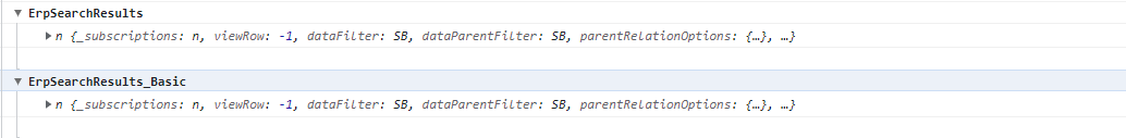

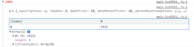

Seems both ErpSearchResults tables are empty even after running both example row-updaters
My CAPA table shows it got an empty update and all the actions fire off.
In my mind looking at this, it feels like it isn’t selecting the record correctly and/or passing/filtering it to the ErpSearchResults table correctly

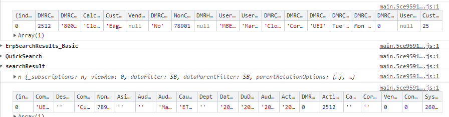

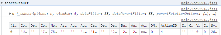

Took a look at my dataview-filter-set and it was set to = searchResult.DMRCorAct_ActionID.
However, the debug table had only ActionID so I changed that out and it fixed the ErpSearchResults return.
It filters down, but to the wrong record. I select 1355 and it returns record 4.
If I go back to the searchResult table, it still shows viewRow as 0 and row 0 is ActionID 4.
So the filter is working properly, but there are two issues.
1: searchResult is not setting to the record that I select

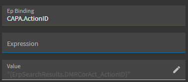

2: the record is not row updating my CAPA view

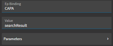

For #2, I am telling it to update the ActionID from my view. I tried it with an Ep Binding of both CAPA and CAPA.ActionID. The “{Table.Field}” matches the field name displayed in the debugger for that table.
I tried it with a static value of “4” just like the record is returning and nothing populates into CAPA view either.
Weirdly enough, after deleting the “row-update” action, both the searchResult and the ErpSearchResults reduced and filtered to the correct row.

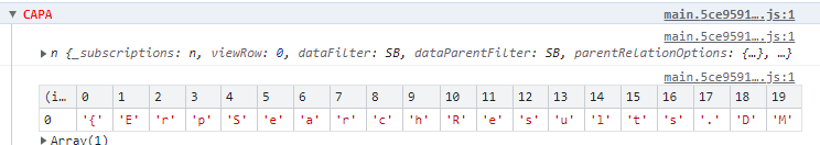

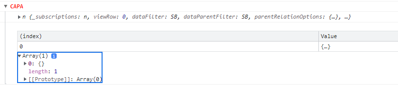

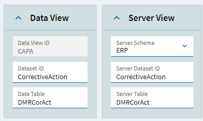

Scrapping the rest-erp as it doesn’t seem to be injecting into the CAPA view, at least row-update was turning it red with null data. Speaking of - it’s a new dashboard with a new view, there are no rows to update :smiley: Trying to swap it into row-add
Well, that’s a row all right haha.
Seems the value is getting added to the CAPA view but none of the predefined columns are showing up and it doesn’t map the row to it.
I feel like I’m very close. It feels like I still need to somehow populate the entire CAPA view with the DMRCorAct table and filter it down instead.

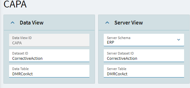

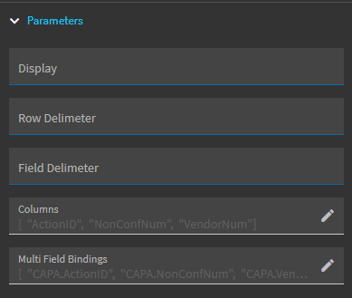

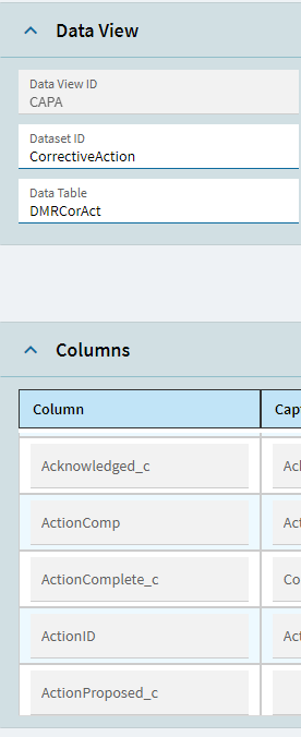

Edit: For reference, this is my CAPA view populated with columns on the application studio screen.
Definitely having issues binding to the schema of the table.

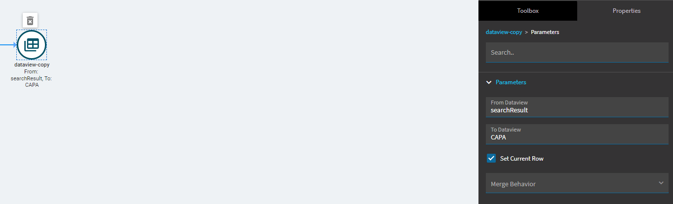

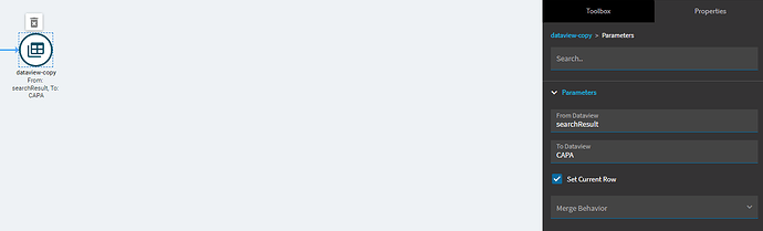

Achieved it through a dataview-copy as my CAPA is an empty dataview.
I think I’m understanding these tools a little clearer now.
Thanks @hmwillett !

No. This should only ever have 1 record if your search is set to SingleSelect.
After looking at it in 2023, this appears to have changed. SearchResult will be the only one you should need as it appears to be working properly without needing to do any dataview-filter voodoo, so that’s cool. If < 2023, then you’ll probably still have to deal with that mess.
