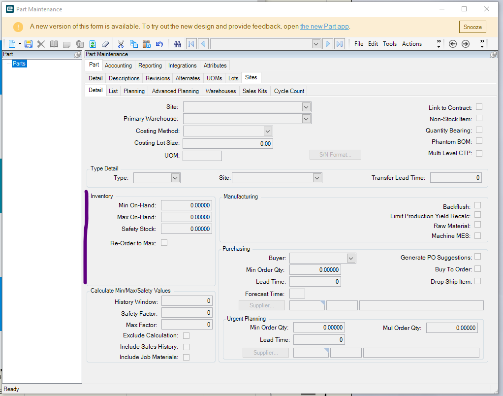

Put a minimum on hand for each part?
I agree with @hackaphreaka , a temporary adjustment to the inventory stock/safety values seems like a sensible approach
