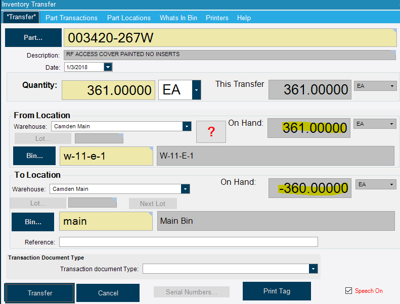

Negative FIFO onhand qty revisited
We are getting this error on Inv Transfer:
This transaction will result into a negative FIFO onhand quantity. Transaction not allowed.
Here’s what we are attempting:
Problems:
Refresh Part Quantities And Allocation does not resolve the problem.
Any thoughts to push me in the right direction?

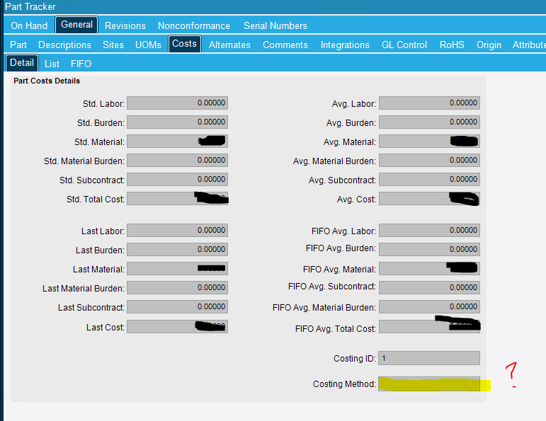

Check the costs tab on Part Tracker. What cost method is this part?
Thanks @markdamen
Should be standard but here is what I show:
I have no idea what any of this means.

Comparing data from the previous version I can see clearly there is a difference in the costing type of the parts. Regardless, you would think a costing type of NULL would be a red flag.

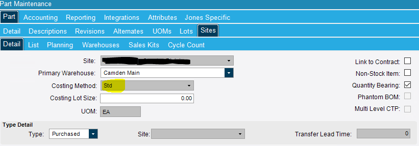

Interestingly - why is this shown in Part Maintenance:
Seems the Cost Method has been lost somehow, and your onhand quantities on the FIFO screen don’t match actual on hand. Check your backups to see if you can find what cost method was set to.

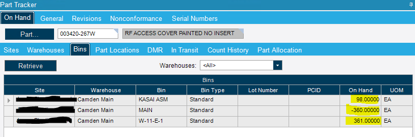

System does not allow you to transfer more than what is in the TOTAL WAREHOUSE. In the Example below – they only have a total of 99 on hand:
Broken out in the 3 bins below:
KASAI ASM 98
MAIN -360 (yes, negative, the system lets a BIN go negative, but the warehouse as a total can NOT go negative)
w-11-e-1 361
Any thoughts on how to get around this?
can you do smaller quantities per transaction? Moving won’t change your total, so move 99 or less at a time?
@Banderson Yes we can - but realistically, we’re not gonna do that :smile:
It’s a one time fix isn’t it? If you keep going negative with FIFO costing, your costing is going to be screwed up. So once you fix all of the negatives, you shouldn’t have to do it again. RIght? So smaller quantities in the transaction would be a lot easier than forcing some code wouldn’t it?

But to answer your original question, you have to do a quantity adjustment to bring the negative bin to 0 and the positive bin to 1. Like you found out, you can’t do an inventory transfer.
