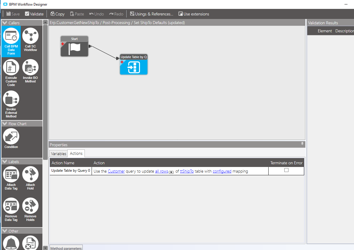

Right. That’s what I’m trying to figure out. I need to get data from the Customer table before I can set the field… That’s where I’m stuck. (I thought ‘Set by Query’ would get me there, but I haven’t been able to make it work properly)
Oh I see, you are trying to set new ShipTo rec field values from Customer values but you’re saying that the Customer values are not easily available in the widgets during this method call?
What method/BO are you using? I’ll be able to take a better look and screenshots, etc.
Customer.GetNewShipTo / Post-Processing is where this current code runs
(I see a bunch of temp tables in this method, but the ttCustomer doesn’t seem to have data).
Got it!!
